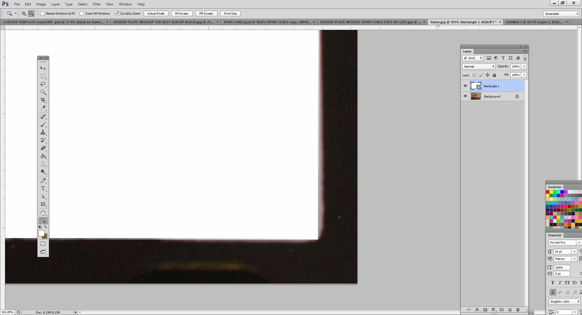

You can do it, but it's easier to just make a new frame. To do what you're talking about, though, here is one way:

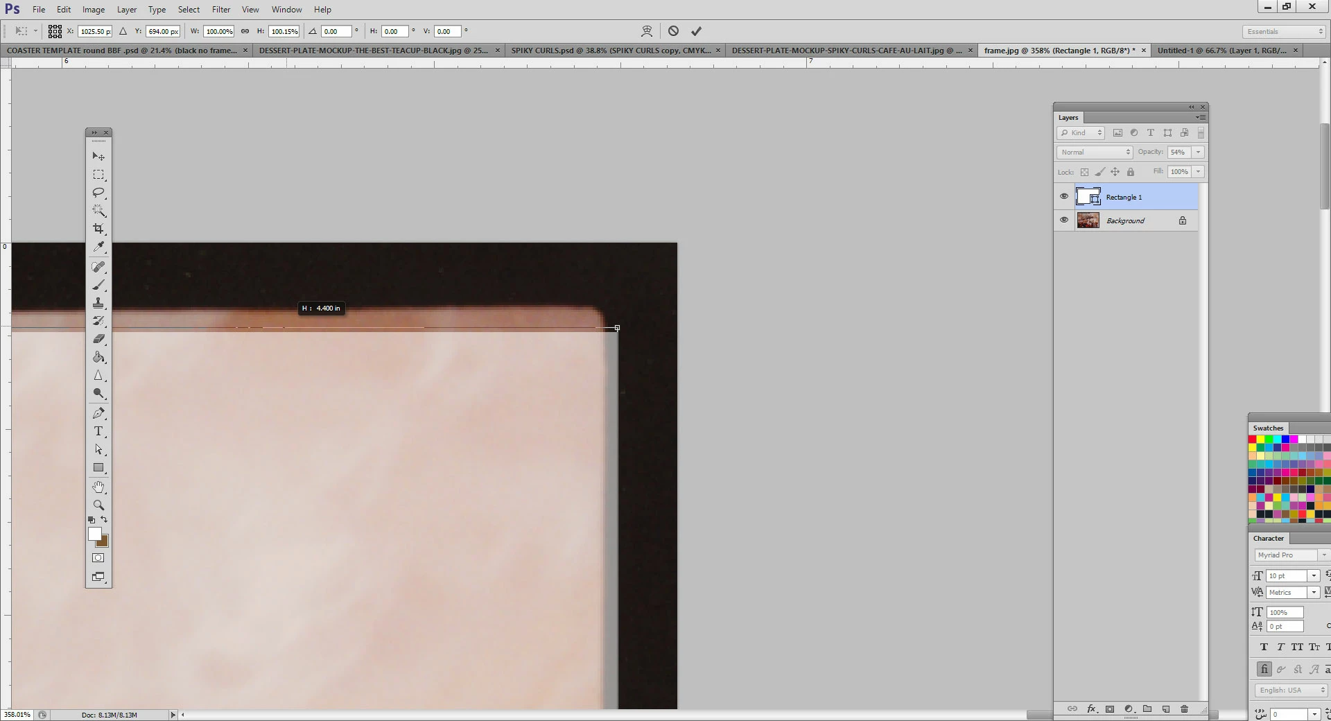

With the Rectangle Tool, make a rectangle to fit inside the frame:
Lower its opacity so you can see the frame beneath as a guide:

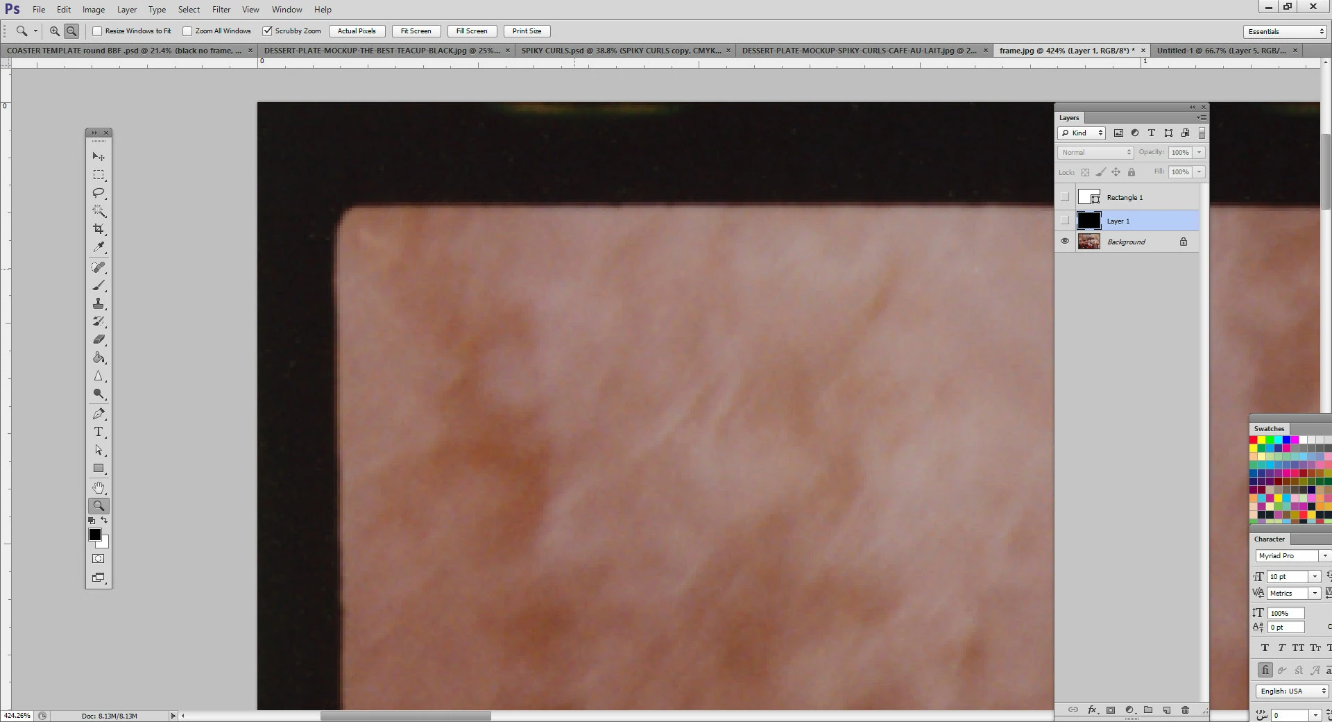

But what I found while doing this was that the black frame is not crisply or evenly defined:

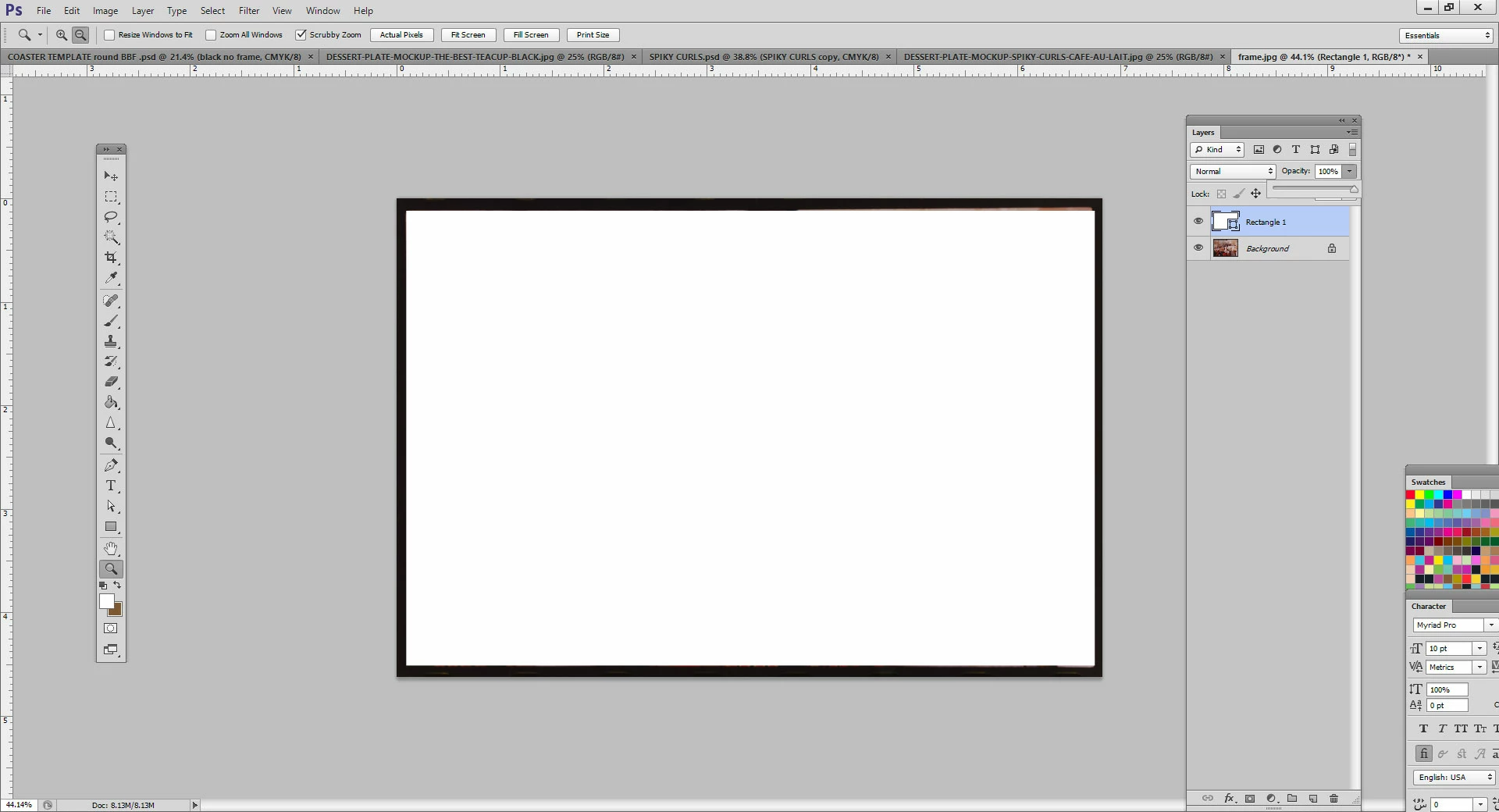

So when my rectangle was done, the result was uneven:

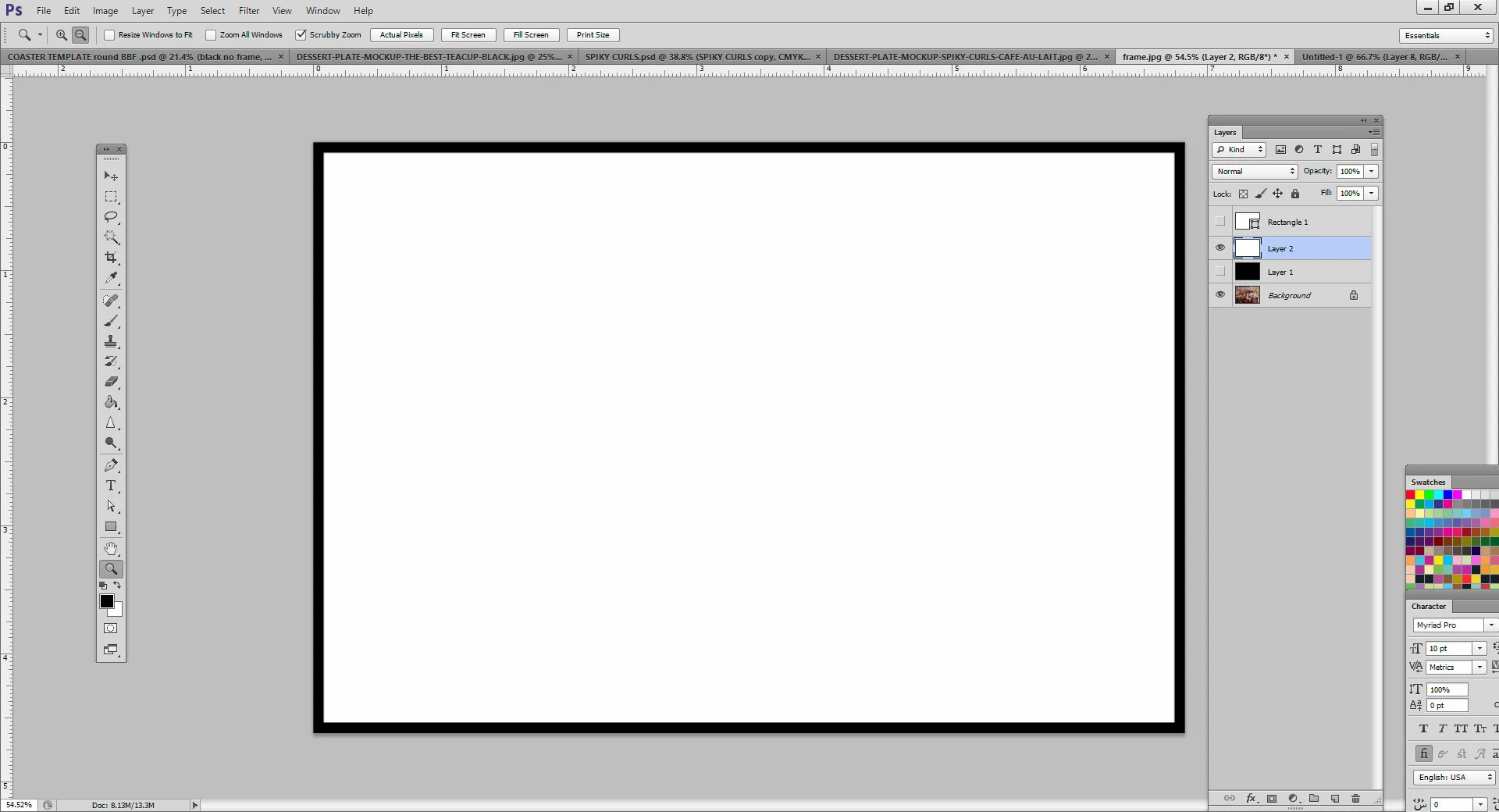

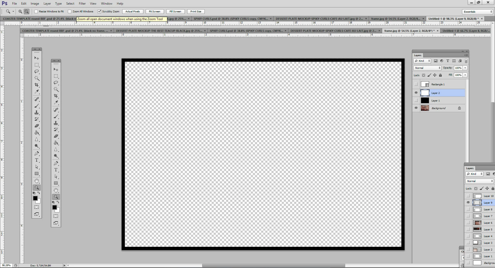

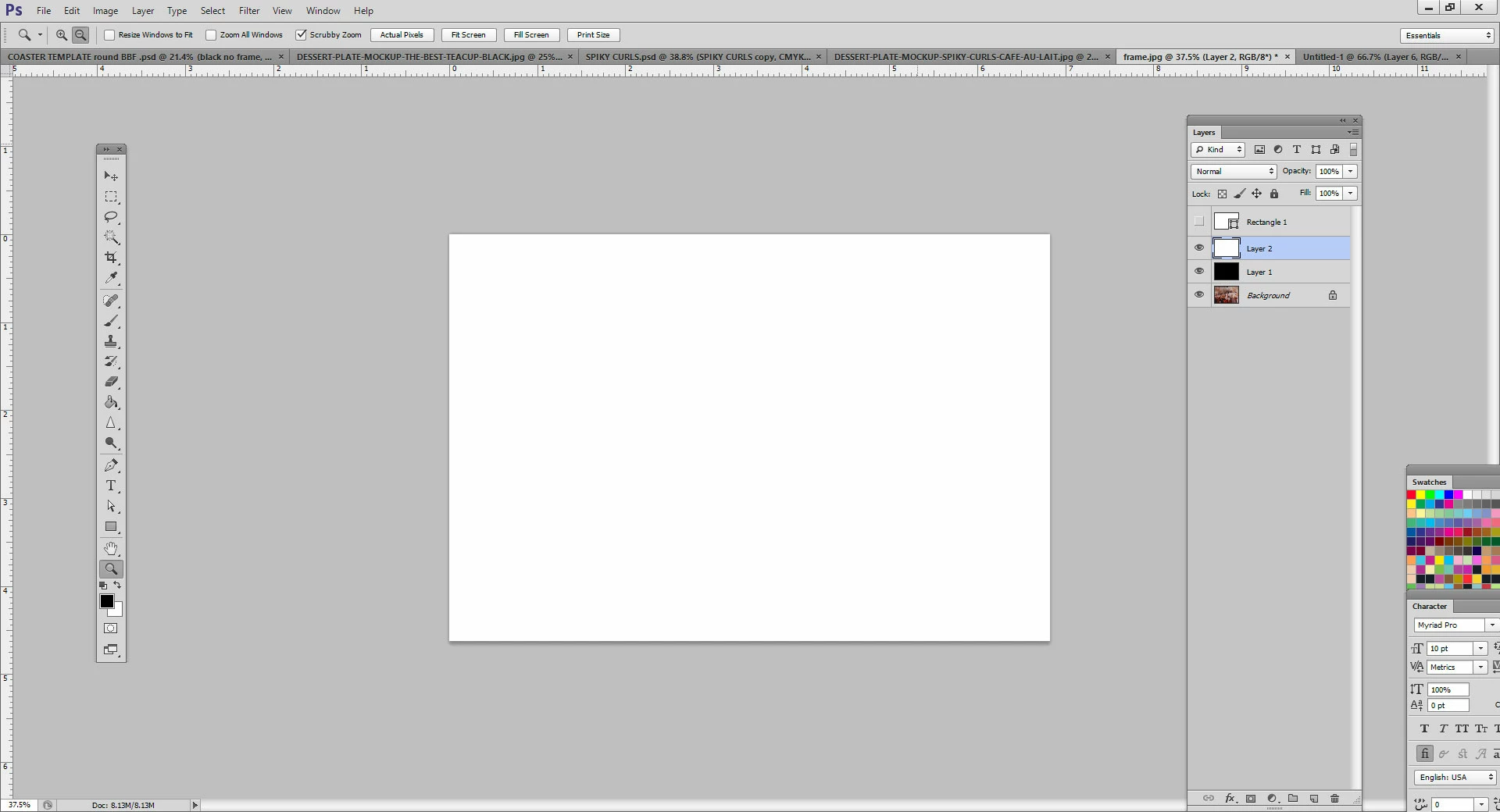

So I made a new frame by first filling the layer with white:
Then I set the brush to 50 pixels (you can make it any width you like of course) and went Edit>Stroke
Then select the center with the Magic Wand Tool. then Edit>Cut, and now you have a clean frame into which ou can insert any image.

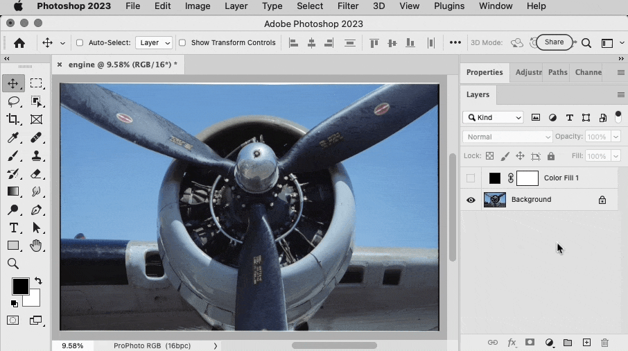

Photoshop has rounded corner controls for rectangles, so you can achieve that, if you are willing to create a synthetic mask (not using the frame from the real scan). This is much easier to control and edit if you create it as a vector mask instead of a pixel mask. Here are the steps for the demo below:
1. A solid color fill layer (Layer > New Fill Layer  > Solid Color) was added in front of the image, set to black, and then selected.
2. Select Rectangle tool, and in the options bar, set it to Path.
3. Drag to create a rectangle.
4. In the Properties panel, set the corner radius to whatever you need. You can enter a value, but I use the visual shortcut of “scrubbing” the value (position pointer over the option’s icon, then drag left or right) to adjust it.
5. Choose Layer > Vector Mask > Current Path. The selected path becomes a vector mask for the solid black fill layer.
6. In the options bar for the selected path, set Path Operations to Subtract Front Shape. This uses the vector mask path interior as a hole in the solid layer, instead of showing the path interior as solid.
7. If needed, adjust vector mask path at any time, including size, position, or corner radius. (Path must be selected in Paths panel.)
