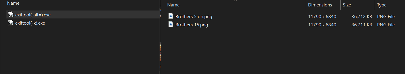

Best method I found and can do it in batch:
- Download Exiftool at https://exiftool.org/
- Extract the tool and rename "exiftool(-k).exe" to "exiftool(-all=).exe"
- Drag your files and drop onto this program icon
WARNING: by doing this will remove all metadata from these images, but it will remove the Metadata Junks for sure.
Attached is the GIF video of how I do this:

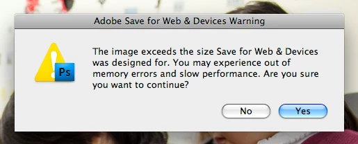

This was my fist step and here is what pops up:
I click yes, though not sure if I should proceed at this point..

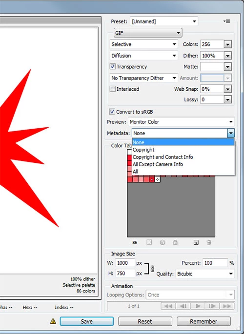

Then the page below pops up in which I apply "none" for Metadata.
I click save and then check the image size.
The metadata is gone (excellent!)

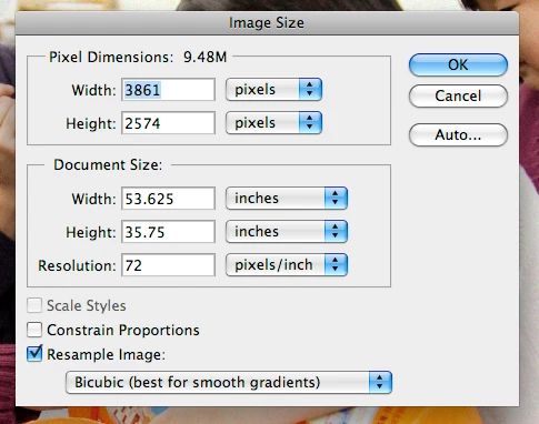

The problem now is that the PPI has defaulted to 72 PPI, from it's original size of 300 PPI (see image below).

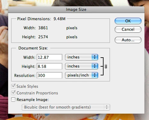

I then manually check and uncheck choices on the bottom left then reset the PPI to 300.
The width/height/pixel dementions fell into place as they should.
I dont want to manually make this adjustment on each image..
How can I get this program to leave the images at the above ratio or...is there another way to approach this through photoshop CS4?

Using Save for Web the PPI information will be removed if you select "None" for the metadata (so defaults to 72PPI) if you use "All" or  "All Except Camera Info" the PPI will be retained.
