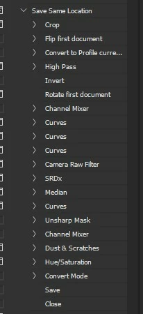

Here's an action sample I use quite often but if I were able to give the steps my own name, I'd put in a lot more steps that could be toggled on and off. There are three curves in here, each with different amounts of auto clipping and I know by memory what they are. I'd start adding mulitiple other steps as well but it would start getting confusing as to what is what. Sometimes I also want to add a temporary step and it ends up with the same name as the perminent step.  Sorry, it's really hard to describe my workflow and why I'm doing things this way...ultimately, it would be nice if I could just double click on a step and rename it. I do realize you can expand an action name and see some of it's peramiters.

Hi, I'd rather duplicate the action with a new name rather than activate sub-steps... double-clicking lets you change settings/re-record a step.
