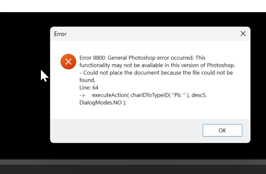

  return app.activeDocument.activeLayer;
This is last last error
