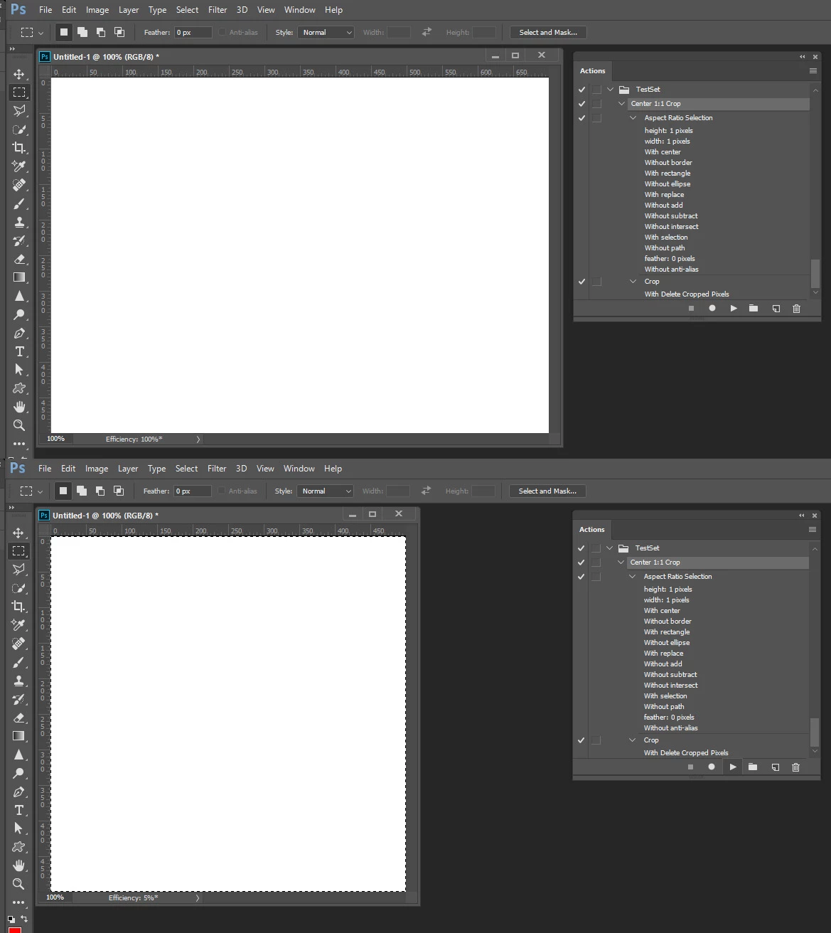

JJMack
October 3, 2017
two step action
Step 1 Aspect Ratio selection  1 1 center rectangle replace selection
Step 2 Image Crop
Action can be batched....

October 3, 2017
Hey JJ, how do you get to the aspect ratio selection screen? Thanks for the help, kind of a noob at this stuff and trying to figure it out.

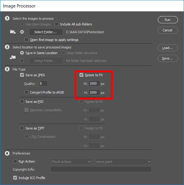

Yes, that can be done, but if you want the 1:1 ratio, you really need to manually crop, or you really don't know where the image will be cropped, unless you don't mind distorted images. Image Processor will resize image to a max size.

I am actually resizing the canvas to 1:1 after trimming so its the canvas that I need at a 1:1 processor so the image won't get distorted as you said. Can image processor resize the canvas to a max size as well?
Chuck Uebele
September 12, 2017
Image processor will resize the longest side image to whatever you put in the field to resize it to.
