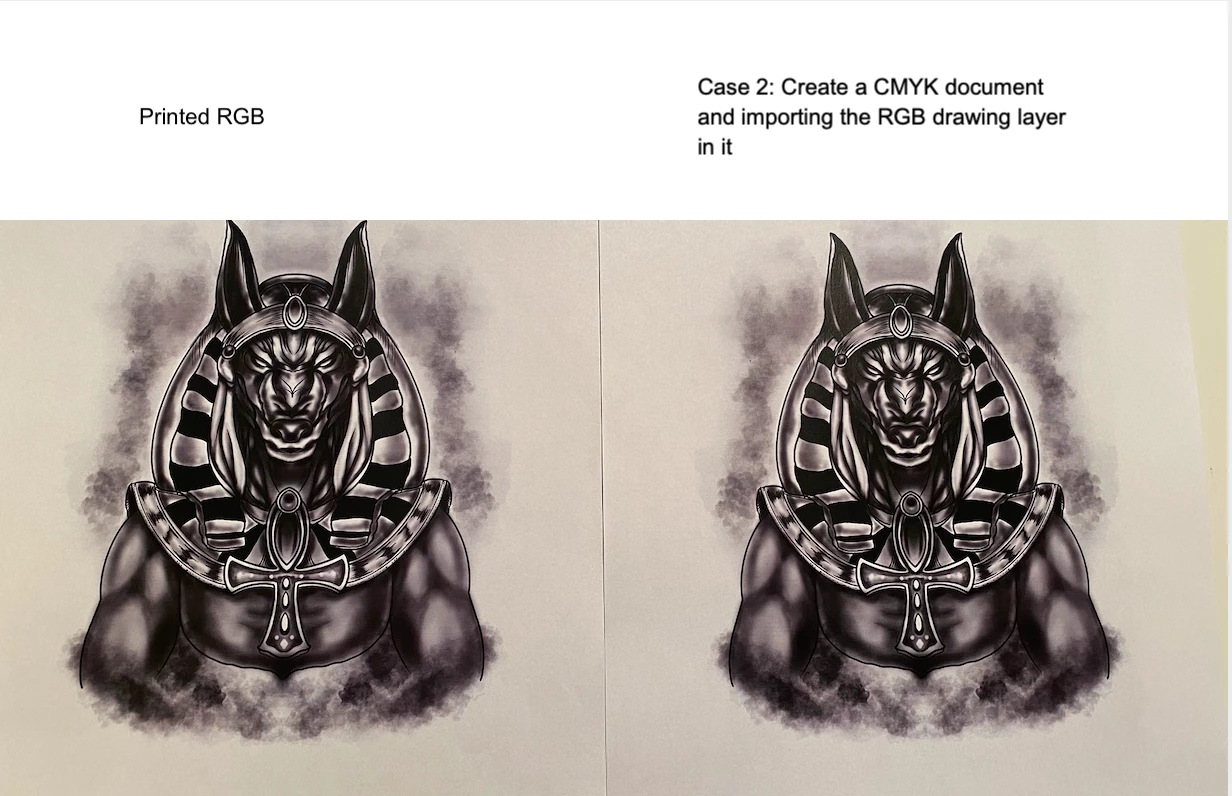

I have an image (a drawing) in RGB.
For printing purposes, I have to convert it to CMYK.
So here is what I did:
Case n °1
I open the RGB file and go to Image > Mode > and switch to CMYK.
I print it.
Case n °2
I create a blank CMYK file and paste the layers of the RGB drawing into it.
And I print.
While the 2 documents are now in CMYK, I have huge differences when printed.
Converting directly to CMYK (case 1) darkens the design a lot when printed, whereas importing the RGB layers into a blank CMYK document (case 2) leads to nearly the same color as the printed RGB.
I'm attaching 2 images:
- 1st one is to see the CMYK differences when printed (case 1 and case 2)
- the 2nd one is to see that RBG and case 2 printed out are very similar.
Can someone help me to understand those differences, and what should I do have perfect printed colors ?

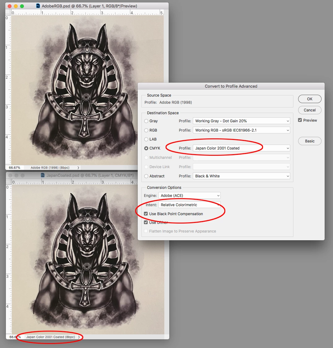

rob day
October 17, 2020
So I suppose I have to pick the same profile ?
Yes. If the designer has assigned Japan Color Coated to her AI file, then you should not convert to a conflicting CMYK profile.
While keeping the file as RGB and delaying the conversion until export or output is a more flexible workflow, if it’s required you can still make the conversion to the final CMYK output space in Photoshop as long as you know the destination profile, which is apparently Japan Color 2001 Coated.
If you make the conversion via Image>Mode your current PS Color Settings are used to make the conversion. It might be better to use Edit>Convert to Profile where you can specify all the conversion options. Relative Colorimetric will attempt to maintain the color appearance when the color is inside of the CMYK gamut :
If I place the AdobeRGB version and the Japan Color 2001 version in a CMYK AI file with Japan Color 2001 as the profile assignment, the output values of the 2 versions will be identical:

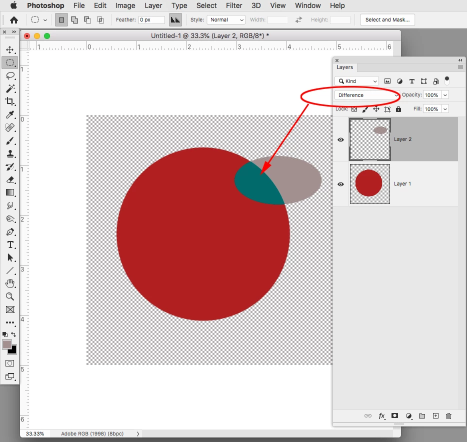

D Fosse
October 18, 2020
The conversion you are showing is from Generic CMYK to Japan Color Coated (a CMYK-to-CMYK conversion).
Do you have the original RGB version of the artwork? The ideal would be to make one conversion—RGB-to-CMYK—rather than your RGB-to-CMYK1-to-CMYK2. A conversion directly from the original RGB space using Releative Colorimetric will maintain the original color, which is what I assume you are looking for.
You don’t have to flatten on the conversion, but if you are using certain color blending modes they will function differently if they are not flattened, and you might get an unwanted a color shift.
For example the Difference blend mode works differently in CMYK mode than it does in RGB:
And also any adjustment layers will change appearance, as the numbers get a new meaning in the new color space.
