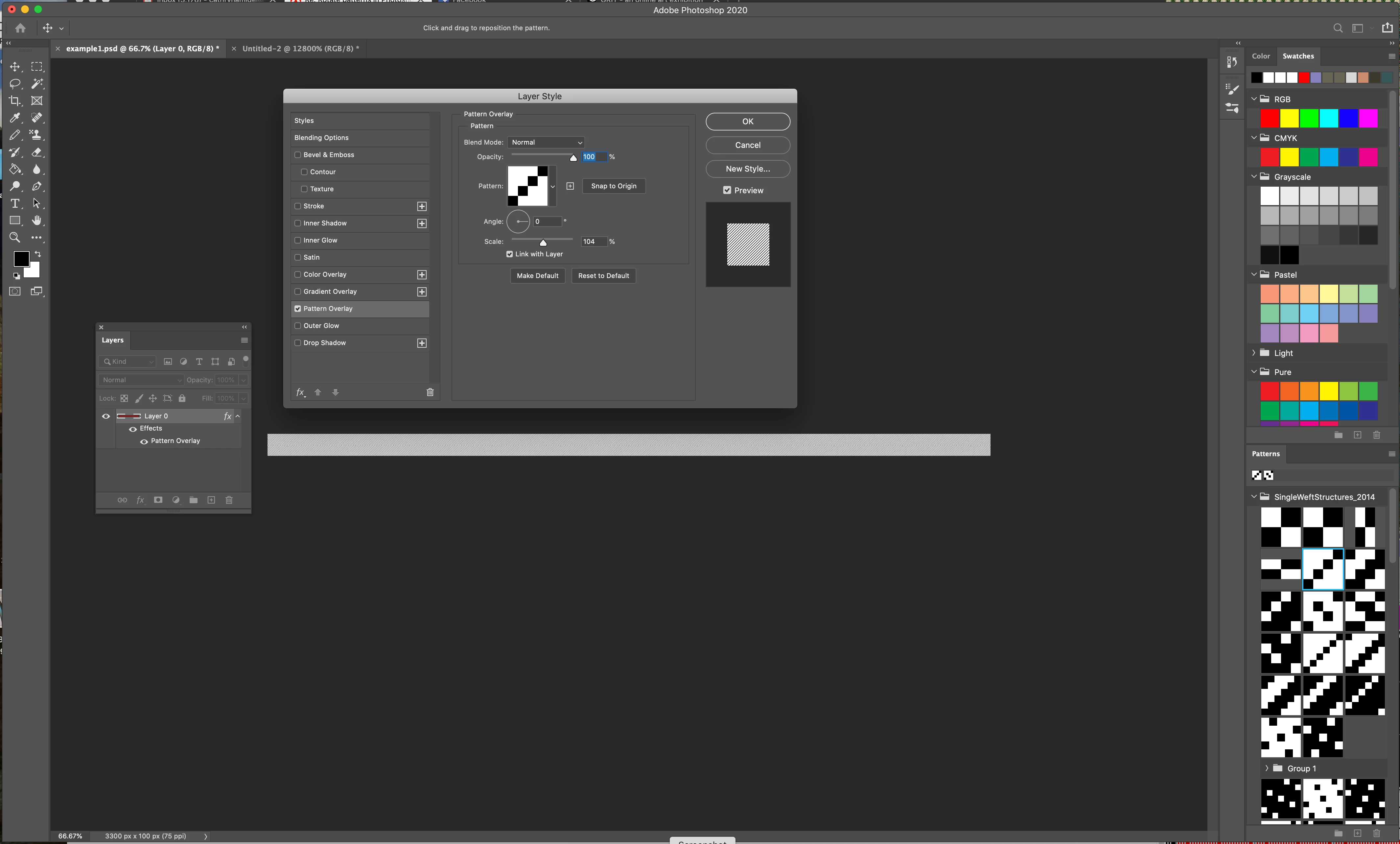

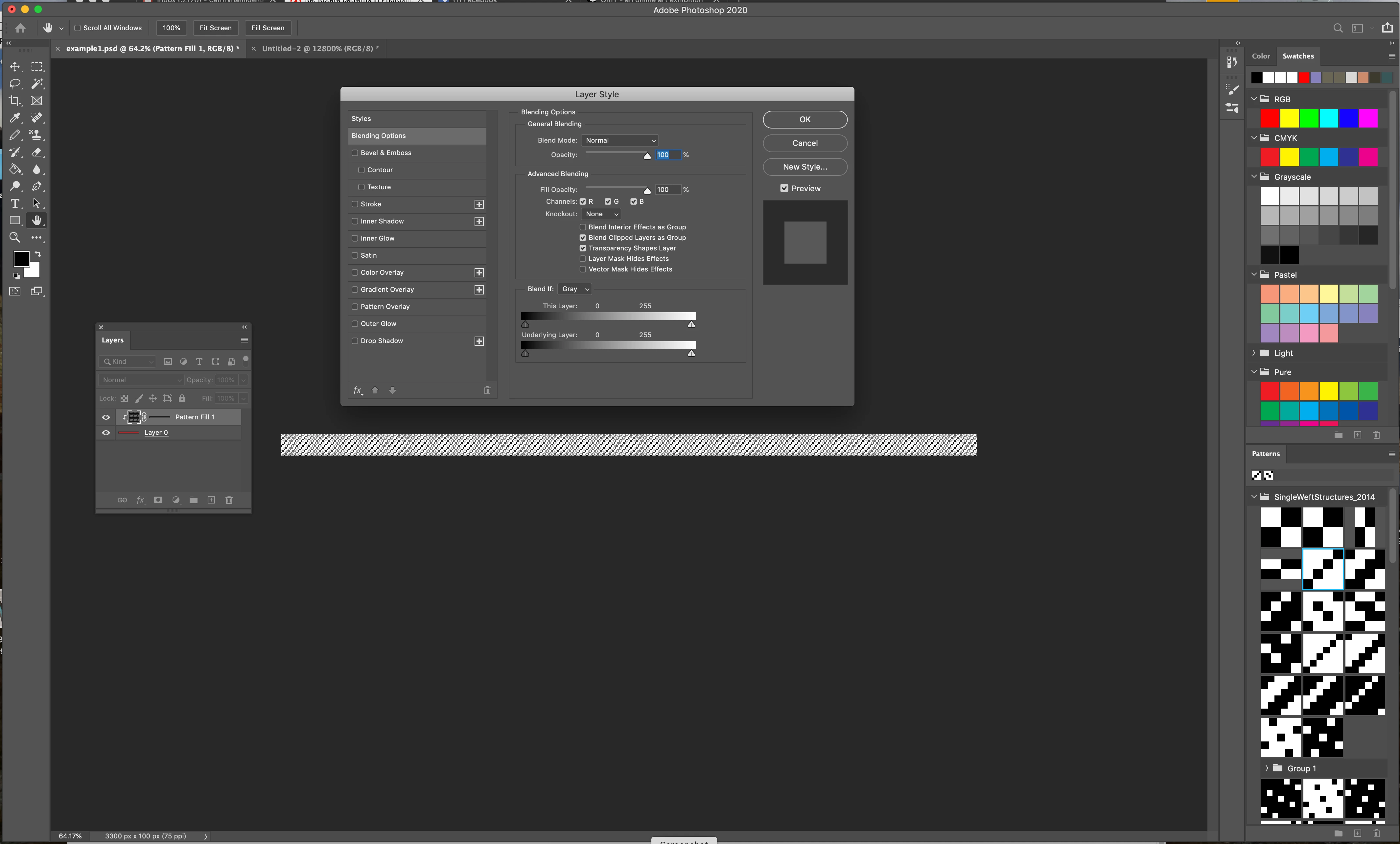

August 10, 2020
not sure how to respond to this question: "what do you want from us???" extra ???? because????
I will assume you are trying to be funny and not patronizing.
Here are 2 new larger  screen shots.
Top one shows: a single layer of color with a layer style /pattern overlay.
The pattern overlay comes in at 104%. Why?
This screen shot- below- shows the same file with a pattern applied via the new pattern panel.
I looked at the blending option to see the scale of the pattern. It comes in at 100%.
I do not use any of the blending options. The pattern should completely fill content in the layer at 100% with 100% opacity.
What I was hoping (repeating here....) was a reason WHY SOMETIMES the pattern overlay comes in at more or less than 100% and what workflow needs to be used to ensure that it does.
