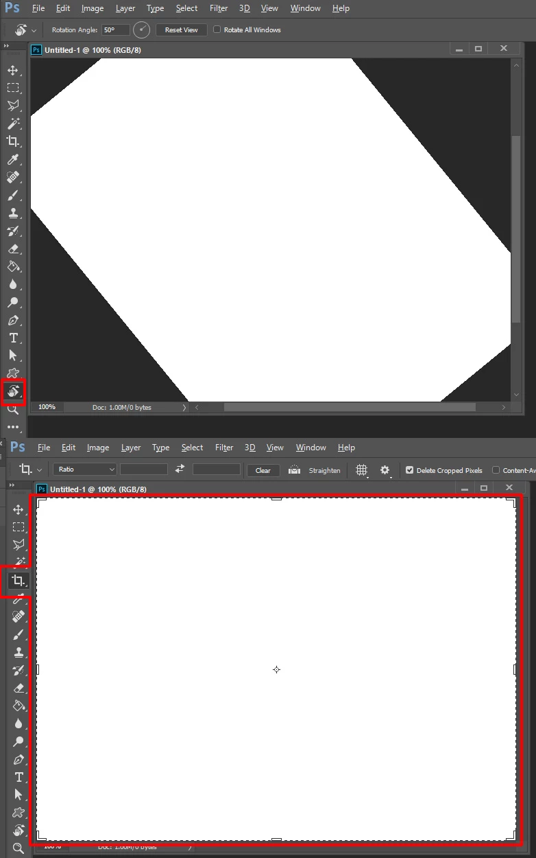

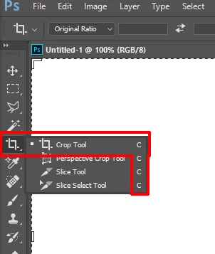

    However C is not only the Crop tools shortcut key it is also the perspective croptool shortcut key and the slice tool's shortcut and the slice selection tool Shortcut key.  Only the crop tool will reset image view retation first thing.  The other tool will not reset view rotation.

    I know C is the crop tool.  However, up until a couple of weeks ago, when I would hit R, for the rotate view, and then C it would return my image to the proper orientation.  Something has happened so that using C will no longer work to reorient my image.
    Any ideas?

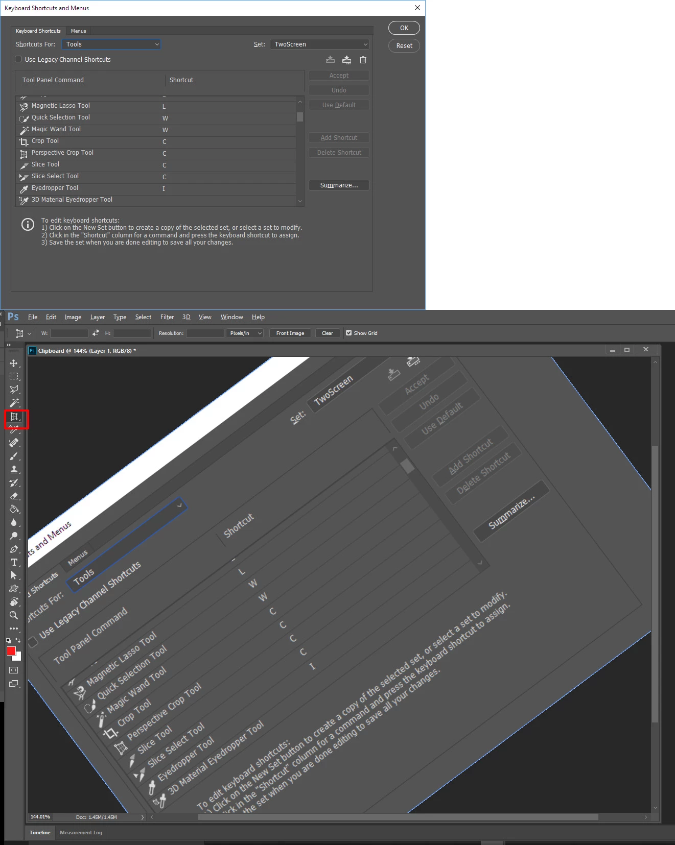

    It would be strange that Photoshop would see your R key then not see your C key shortcuts.  Make sure you have not switch the tool bar to some other tool in the group for the C short.  You may be able to create a separate tool icon for crop in a customized toolbar and edit your Shortcut keys and remove the C from the other tools that also have C as their shortcut key.

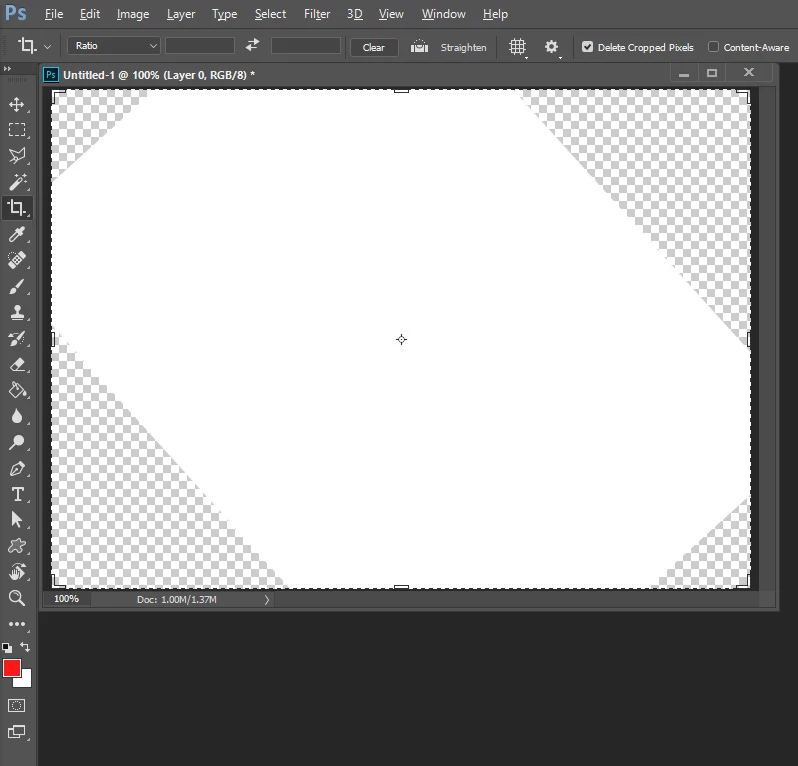

    From where could you use C?  C is Photoshop shortcut key for Photoshop's Cropping set of tools...
    If the rotating tool is active tool  C seems to work for me and it also switches to the crop tool. Switching to the ceop tool seems to reset images  rotation
    However, it will not un-rotate an image that has been actually rotated.  Just the image view rotation will be reset.
