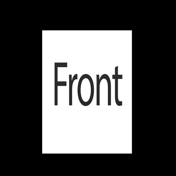

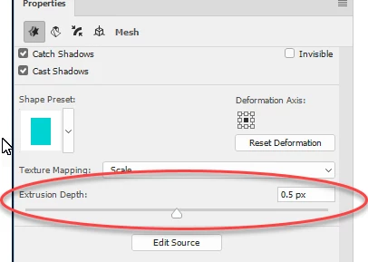

1. Draw a white rectangle using the rectangle shape tool
2. Make a 3D extrusion from the rectangle and in Properties reduce the Extrusion depth to 0.5px

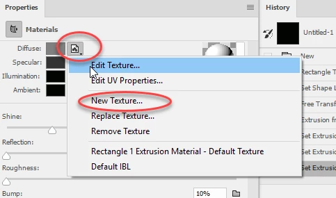

3. Click on the front inflation material and then in properties - Diffuse on "New Texture"

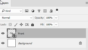

Add your text or design as a smart object in that texture - I have just used the text word "Front"
Save the texture and close it.
4. Repeat step 3 for the Back inflation material. Note you will need to flip the smart object to reverse the lettering when working on the back material

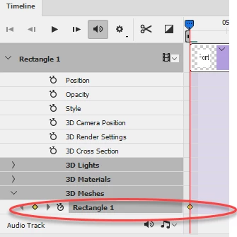

5. Open the timeline and create a video timeline
Add keyframes under 3D meshes for the rectangle
Five keyframes should suffice 1 at each 90 turn and the last the same as the first
6. Render the video. I have just used a Open GL render below for quickness rather than quality then exported as a GIF
I hope that helps you
Dave

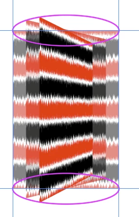

You could do this by hand, with a number of duplicate layers. and two elliptical guidelines. Transform each duplicate by a different width using the Sine function in a calculator or spreadsheet, and before committing the transform, Control+Shift drag the corners to the ellipses, like so:
You'd do similar for the other side. The "On edge" frame would just be a blank layer.
Once all the layers are set up, make the animation as usual.
