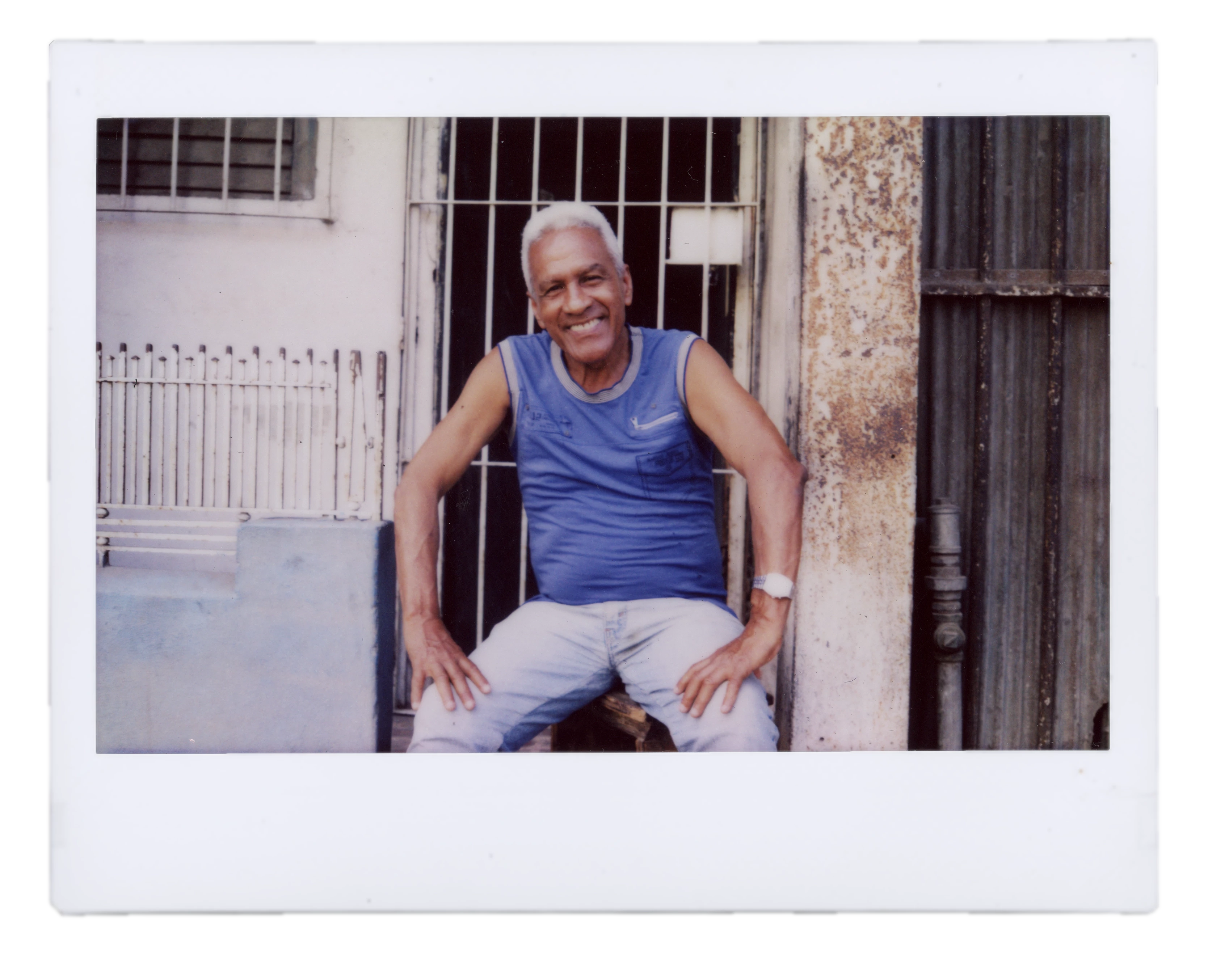

I scanned some polaroid and instax wide instant film from a friend's wedding. I intend to print a wedding book with the digitized instant film images. I used a homemade black scan adaptor to avoid newton rings (see below, image #1).

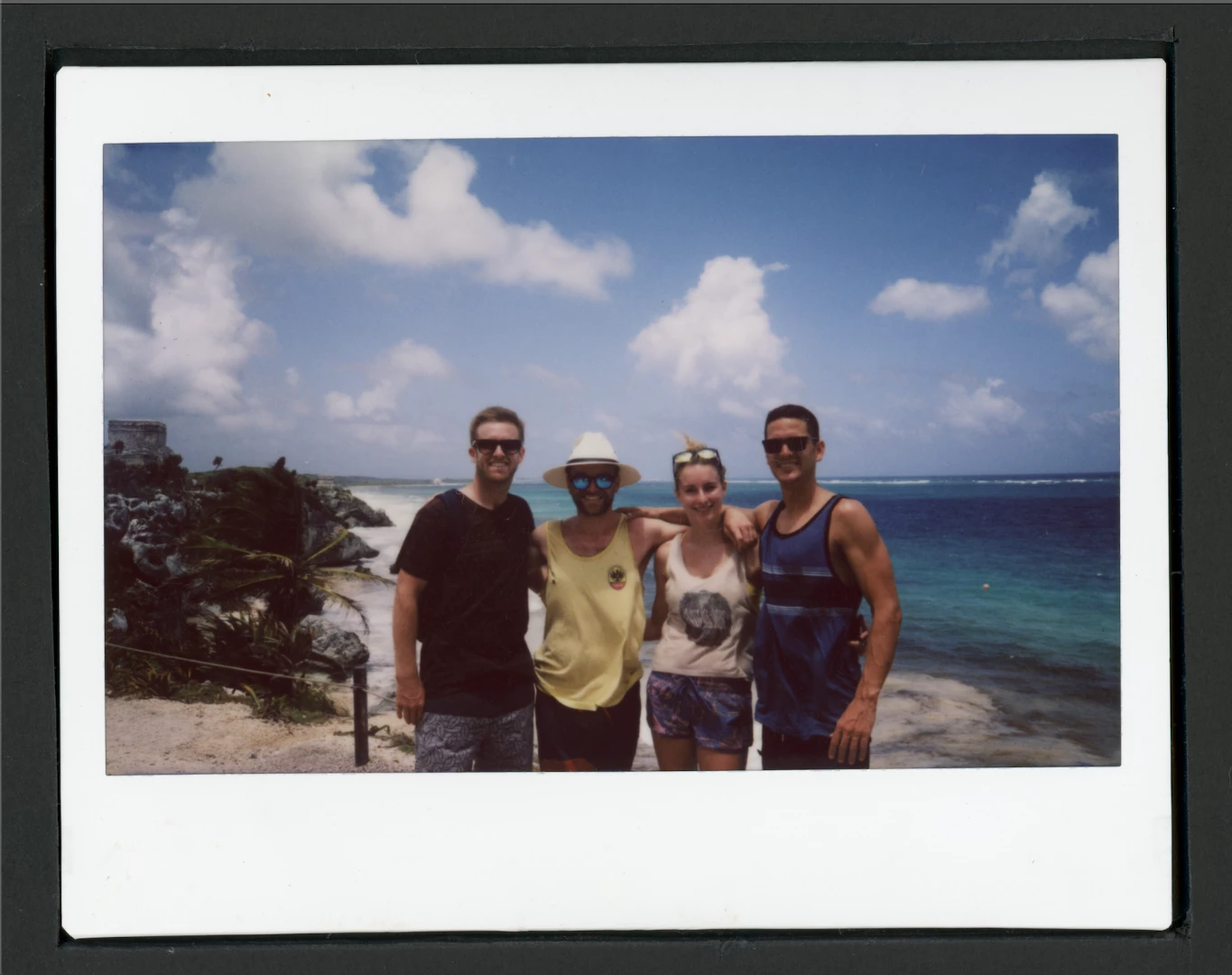

PROBLEM: When I select and remove the black background from the scan adaptor, the white border of the polaroid/instax is not super smooth...It looks jagged (see below, image #2).

Image #1: Scanned Image with adaptor border:
Jagged Edges Image:

Thanks so much, I really appreciate it! I used your settings for another photo and it worked fairly well. What settings would you suggest changing for the top left jaggedness in the photo below?
