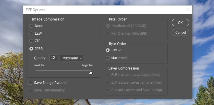

On my old PS CS5, I could set up my file preference to save as a tiff file with jpeg compression which will produce a file around 12-40 MB each automatically all I had to do was hit enter every time. But with cc, I have to 1.save as, 2.add the suffix letter, 3.click jpeg compression, 4.IBM PC, 5.then enter, that's 5 steps I used to do with one in CS5, Now I have been waiting for several years since cc was created hoping someone would fix this. The other image compression options LZW, Zip, & None produce much larger files than I want to store. Also, I wonder if this is a Lightroom issue since I am going from and to lightroom and it's prefs only allow the above options for importing back in? Is it possible to make some sort of shortcut, or do I need to go back to CS5? I have tried making an action but then it comes up with the same file name as the one I recorded with. Please surely someone else needs this too right?

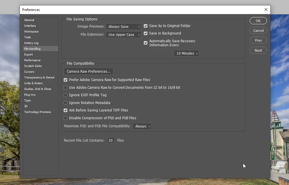

Any images that have been edited in Photoshop I save the master as a PSD/PSB with all layers in full 16 bits per channel with no compresssion (compression disabled in Preferences).   The TIFF equivalent would be the 16 bit with no compression.  Yes the files can be large, but these days, disk storage space is cheap.

Jpeg compression is lossy. The process of compressing the image  throws away image information. That's fine for a final copy to be posted on the web but not for a master file which might be reopened , edited and saved again. The other 3 options are "None" , which does not compress at all, and LZW and ZIP which are both lossless i.e no information is thrown away - it can all be recovered when the image is decompressed.

Do you realise that jpeg compression is lossy (i.e. it permanently degrades the image) and that means that every time you reopen and resave the losses are cumulative. The other compression formats are not lossy and the entire image can be recovered every time.
There are many of us that disable compression altogether which does lead to larger files but with faster opening times. These days disk space is cheap, image loss is not.

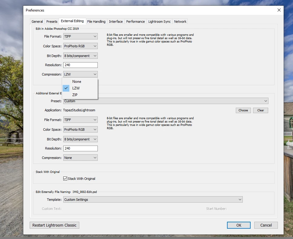

I would also advise against using 8 bits/channel with the ProPhoto colour space (as shown in your Lightroom screenshot) - but that's another issue.

Thanks, davescm I did not know that about the lossy. I guess you're saying I need to just bite the bullet and stop trying to make such small images, right? Same issue with the 8 bit/channel ProPhoto colour space, right
