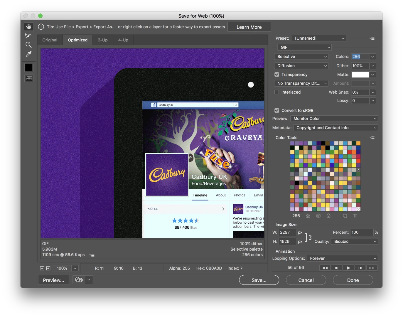

Hello, I'm trying to export a GIF from Photoshop CC (2017) but I keep getting the following error message:
It is an image sequence originally rendered from After Effects CC (2017) - with images named from [...portrait_black_V2000.jpg - ...portrait_black_V2250.jpg].
I have kept the frame rate at 24.972 (what the original video file was set to) and each image is 2000x1600px.

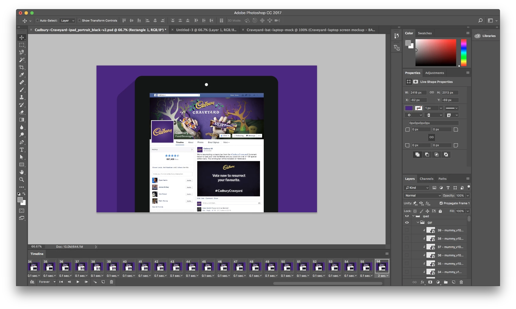

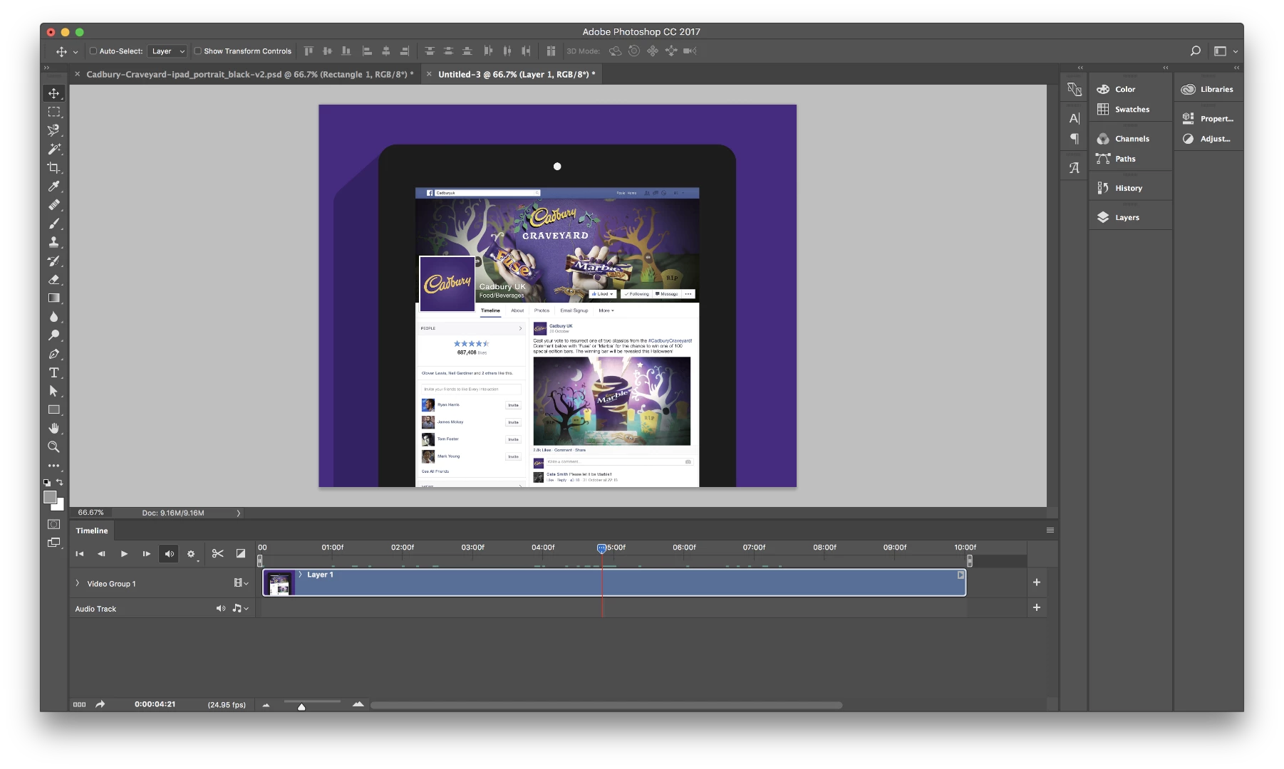

Yep plays okay in the timeline. I am trying to get the video to play in an ipad/facebook mockup, it needs to be a GIF rather than a video file in order to play directly on my Squarespace site. Here's a frame from the timeline...

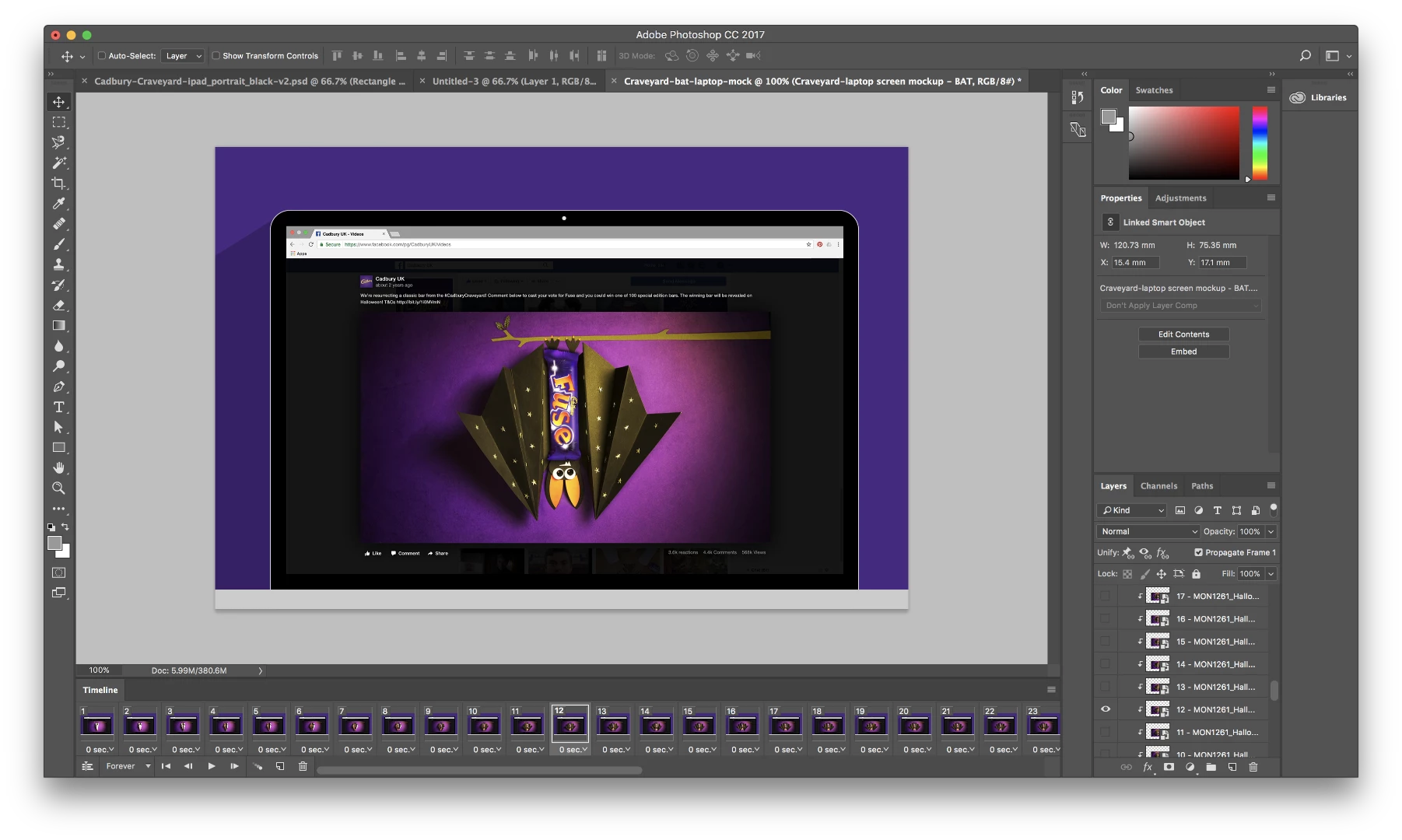

I have managed to do it with some other videos, however they are more simple and at about 50 frames each so I animated the gif by hand using the frame animation toolbar:
I reverted to this method for the video I've asked about (using 56 frames) but now the colour/quality output of the gif is screwed (ie white looks blue). I wonder if i've messed something up trying to fix the original problem as it was working well up until now...

Looks like the Adobe programmer has no clue as to what the error is do you?  Does the animation play in Photoshop's timeline give us a clue to what you doing.  You used AE to create and animation 24.972 FPS a video I presume.  How are you trying the convert the video in Photoshop into a frame animation so it can be saved as an animated gif which will not have great quality for GIF do not support great quality will map colors to 256 colors.  You video 24.947 frames you would not want all those frames in a gif. That gif would most likely be a bigger file than your video file and not play at the 24.972 FPS rate,
