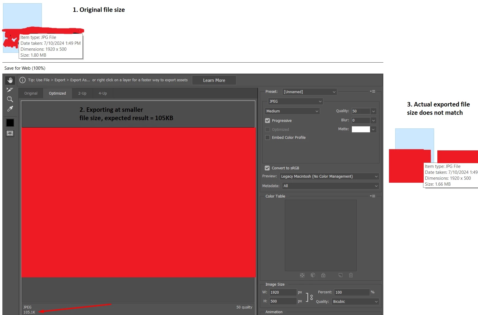

I have a JPG image with file size 1.80MB. I'm trying to reduce that size via Export > Save for Web (Legacy) > lowering quality to Medium, which the dialog window says will yield file size 105KB. But the actual file size after export is 1.66MB. Screenshot included, image blocked out for privacy. The file was created on a Mac then sent to my Windows device.
This has always worked for images at 72ppi, which is the resolution I normally work with, but this image is at 300ppi. I'm assuming that's the issue, but what can I do about it and why does the higher ppi cause this issue? Lowering the ppi to 72 ruins the image.
(I'm not a graphic designer so I'm not well versed in all this, I just post images that are sent to me and sometimes need to reduce their size before doing so.)

Ppi is irrelevant and has no bearing on file size. It's just a metadata instruction for print pixel density, it's not a property of the file.
Mac or Windows is also irrelevant, aside from specific settings that could differ.
I find it hard to believe that you can export a 1.8 MB jpeg at only 105 kB. That might be possible with maximum compression/lowest possible quality, but even then you'd be hard pressed.
If the original isn't an already compressed jpeg, however, but a PSD or TIFF, then those numbers are normal.
Note that resaving a jpeg tends to increase file size at the same quality setting. This is because the compression artifacts are effectively added detail, which compresses much less effectively. I tried to resave a 1.85 MB jpeg at the same settings, which resulted in a 2.2 MB new jpeg.
July 26, 2024
It has worked in the past. I don't actually reduce that drastically at work, this was just a demonstration, but the point is that I could for every other image I've ever been given to work with.
By @Summer35485157hduj
Does the file size change along the way? In other words, what’s the size when it first appears on the Mac after export, and is that different than the size reported in Windows?
