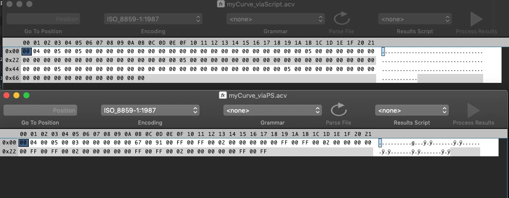

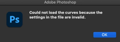

Looking for someone who has any idea how to debug the following script by Mike Hale. Any ideas or even method of were to start would be great, this script is a little beyond my knowledge base....
The Script follows through and saves a ACV file, but it flags the following warning when you try and load the curve. Presumable something has changed in the syntax of the curve preset since CS4 when this script was written.
I opened an . acv of the same curve saved both via photoshop and via the script see below the difference in binary via Synalze pro, i dont really understand how to interpret this data though...

Correct answer Kukurykus
I found a post on PS Scripts in which @DBarranca posted speaking about how curves with 5 curves... Perhaps @DBarranca can shed some light on this conundrum. From my debugging, it seems the data is being passed correctly to the writing part of the script. individual values are passed, but it seems like the way they are being written is not correct, and that is as far as i have got to ...
In theory the data should be pushed to the writing part of the script as follows, as individual input ouput numbers for each point on each curve sequentially, however this somehow mucks up the structure in the script and saves the wrong number of points.
var myACV = new File('~/Desktop/curveScriptMH.acv');
myACV.open('w');
myACV.writeShort( 'LE','4' );// acv header WORKS
myACV.writeShort( 'LE','5' );// acv header WORKS
for( var i = 0; i< 5; i++ ) {
   var numberOfPoints = acvArray[i].length;
   myACV.writeShort( 'LE', numberOfPoints.toString() ); //WORKS
   //myACV.writeByte( 0 );
debugger
   for( var p = 0; p < numberOfPoints; p++ ){
      myACV.writeShort( 'LE', acvArray[i][p][0].toString() );
      myACV.writeShort( 'LE', acvArray[i][p][1].toString() );
When i change the script to pass the values as pairs not individual values it maintains a perfect structure with the correct number of points.
var myACV = new File('~/Desktop/curveScript.acv');
myACV.open('w');
debugger
   for( var p =0 ; p < numberOfPoints; p++ ){
      myACV.writeShort( 'LE', acvArray[i][p].toString() );
In both cases the acv headers are perfectly written and in both cases none of the point values are written correctly to the file....

Gibson Editions
November 19, 2021
I have just realised all the action manager code does is sets the curve not saves it.... will keep going with Mike Hales script...
November 19, 2021
For sure, the last part of the script is missing some arrays reference.
Try with :
