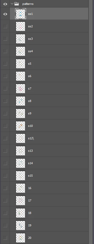

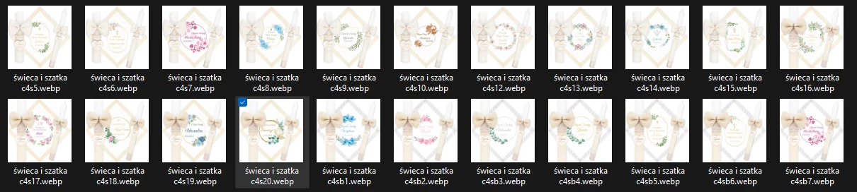

I've approached a little problem with saving hundreds or even thousands of pictures for a web shop. I have at least 20 to 25 variants of the same picture but I cannot move, hide or delete any other layer of group, just this one particular group. Is there any solution besides Layers to Files?
Probably explained it very poorly so I've managed to pull up some examples in attachments 😕😕
I don't mind leaving unchanged names behind, I am just curious if it's possible to save some time with "Save As" option 🙂

tr0j4nAuthor
March 21, 2023
Thank you for this, it would be my first time using this kind of complicated script but I don't know where to start 😄 Do I save this custom script as .jsx file and before running it in Scripts, should I take care of naming layers and groups? I will be filled with tears of joy if it's that easy!
Stephen Marsh
March 21, 2023
@tr0j4n
The first script is generic, follow the instructions for use at the original link.
The second custom script requires the layer group to be named 'pattern' as per your screenshot.
In both cases, the full instructions for saving and running scripts are here:
https://prepression.blogspot.com/2017/11/downloading-and-installing-adobe-scripts.html
Stephen Marsh
March 20, 2023
It sounds like you wish to save all visible layers with only a single layer active/visible from the "patterns" group for each save... If so, start with this script (it saves PNG and PSD, but that can be changed):

A custom solution would likely require a better explanation, sample file, before/after examples etc.
Kevin Stohlmeyer
March 20, 2023
Hi @tr0j4n if your layer names are consistent, you could have an action or script turn layer visibility on and off and save, but you'd run into the issue of file naming. I'm sure somone here may have a scripted solution they can offer.
