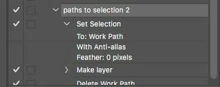

    IMO the reply marked correct is not completely correct.  While Alt+Click Make Selection will record:
    Set Selection
    To: Work Path
    With Anti-alias
    Feather: 0 pixels
    While that is what you want. That action step requires there be a Path in the path Palette named "Work Path".  The action will fail if that path does not exists.   To create an action that will when you are working on a document that may or may not a "Work Path". Before you record the step "Alt+click make selection"  you need  to click stop recording, use the  action palette fly-out menu and click on "insert Path" that will insert a step "Set Work Path" the step will contain a full description of the current active path.  Once inserted click record in the action palette and Alt+Click Make Selection. That action will create  the "Work Path" or replace the current "Work Path' With the inserted path in the in the action. An action can have may different "Set Work Path"  steps inserted in it.  They will all replace an existing "work Path" when the step is played.

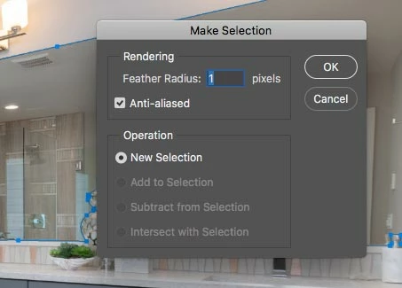

    I should have been more clear. I start to record my action after I have completed my selection with the pen tool:
    I click on the area around the mirror with the pen tool and complete my work path. I then start to record my action, right-click with the pen tool and choose 'Make Selection', and then the dialog box appears:
    It's at that point where I can enter "0" (or whatever feather radius I need). After I enter the value, I make a layer mask and then delete the work path. The action looks like this in the "Actions" panel:

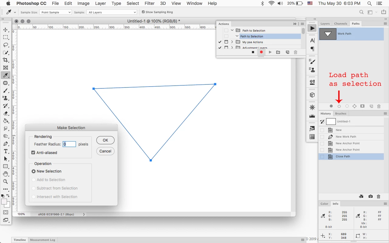

    @Jeff Arola - it looks like your solution works! When I use the method of holding down the 'Alt' key and clicking 'Load path as selection', it records the feathering:
    Thank you to all who replied!

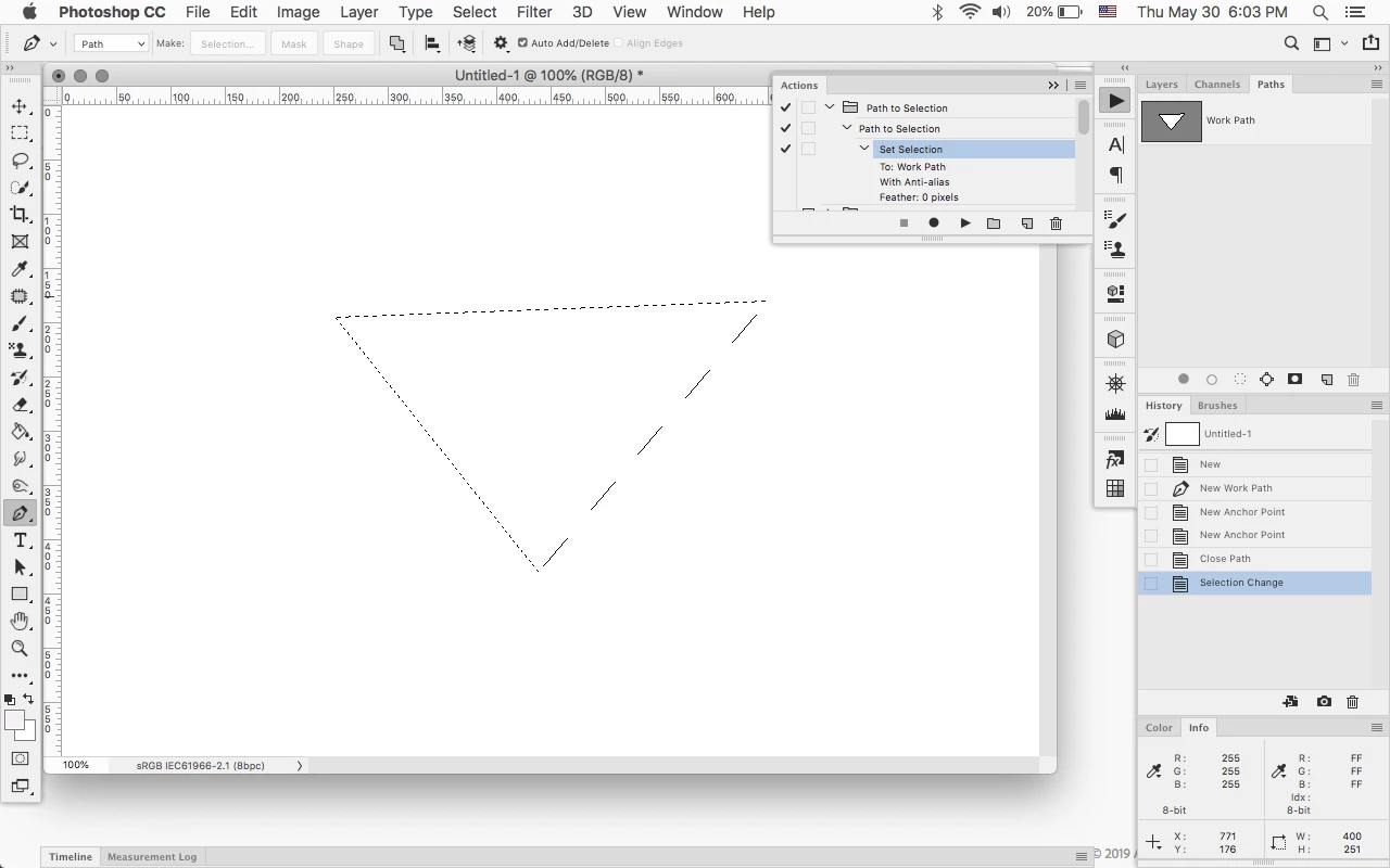

    Jeff Arola
    May 30, 2019
    That seems to be a glitch in photoshop cs6 and above.
    Anyhow, it seems one can get the action to record the Make Selection settings by holding down
    the Alt/Option key while pressing the Load path as selection button in the Paths panel.

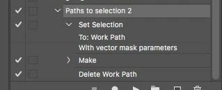

    The action step if you expand it so you can read the full step settings. Will be something like:
    Set selection
    To: Work Path
    with vector mask parameters.
    The problem is the actual  setting ot the pen points to create the work path were not recorded.  So if there is no work path in  the path palette when the action is played the step will fail. If there is work path it may not  be the path selection you want because  there was no path creation recorded in the action,  If the work path is correct there may be some farthing because the was nothing recorded about feathering into the action step all that was recorded is with vector parameters.  So the last fethering settings set when converting a path to as selection is likely to be used. The fathering may not be 0.
    My advice to you would be to use one of the marquee or lasso tools to create the selection. not use the  pen tool and click the selection button.  I have only tested this in CC 2019 older version of Photoshop may do things better.,
    I just tested CS6 it works the same way.  Do not use the pen tool to create selection when recording an action. Its asking for problems....
