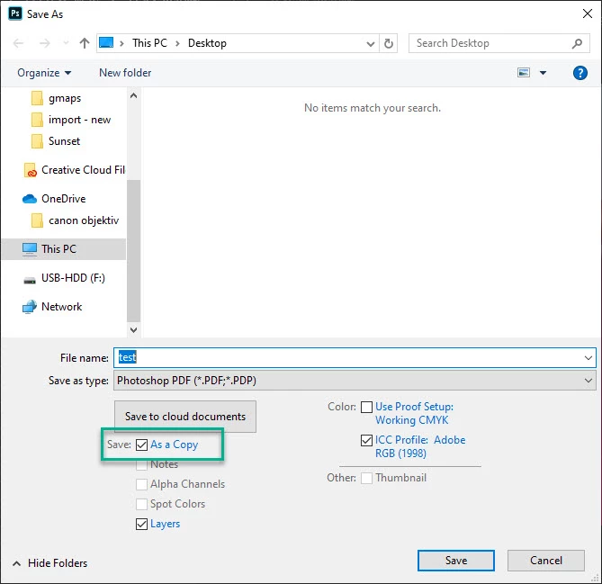

Used to be when you were working on a file and you saved it under a different name or even format the file you had opened would change to that new file and you could go on editing it. It is no longer that way and is real frustrating for those that were used to the old way and now end up over writting files without meaning to do so. Is there an option that I have missed not to do that?
Correct answer Bojan Živković11378569
It does have sense, of course. When saving try to uncheck Save: As a Copy option which is highlighted in screenshot below.

Thank you. I can't believe I missed something so simple. Any reason why "save as copy" is checked when I try to save a PDF file that is in layers in version 21.1.0? That does not seem to be the case for the same file on version 20.0.0 that I have on another system.

If I can understad what are you talking about then behaviour is the same in newest Photoshop 21.0.3 as I am testing. It will not change to test.jpg if you have layered document in Photoshop, do you understand why? Because in that case it must flatten your document since saved document in JPEG file format does not have any layers. Which verson of Photoshop and OS you are using?
