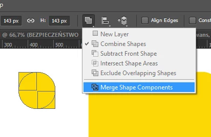

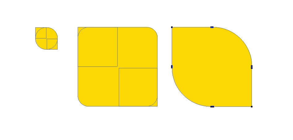

July 24, 2015
So, I just get the same problem:
fig.1 - my original shape.
fig. 2 - shaper after resizing
fig. 3 - after applying just one option
All you have to do, is select your original shape and from shape dropdown menu select "merge shape components". That's all.

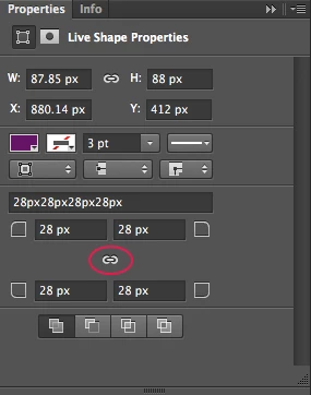

January 14, 2015
When you have the shape selected. Open the Properties panel and turn off the 'link together corner radius values' button highlighted below. The shape will then scale up keeping the corners in proportion. It's not at all self-explanatory, but it works!

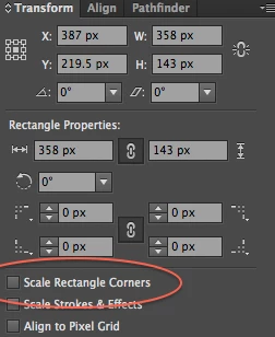

To answer the original question, Illustrator CC 2014 has the option to scale rectangle corners or not when scaling the whole item. Earlier versions do not. Find it under Window -> Transform, then expand the panel to see all options, to find "Scale Rectangle Corners"

July 9, 2014
Just found that if you double click one of the little disks then select your shapes and click "Scale Rectangle Corners" in the "Transform" panel the live corners will scale with the shape...finally...

I guess i must be missing something, but where do you see the choice for scaling rounded corners in photoshop cc 2014?
July 9, 2014
Window -> Transform
Expand the panel twice to show all options
