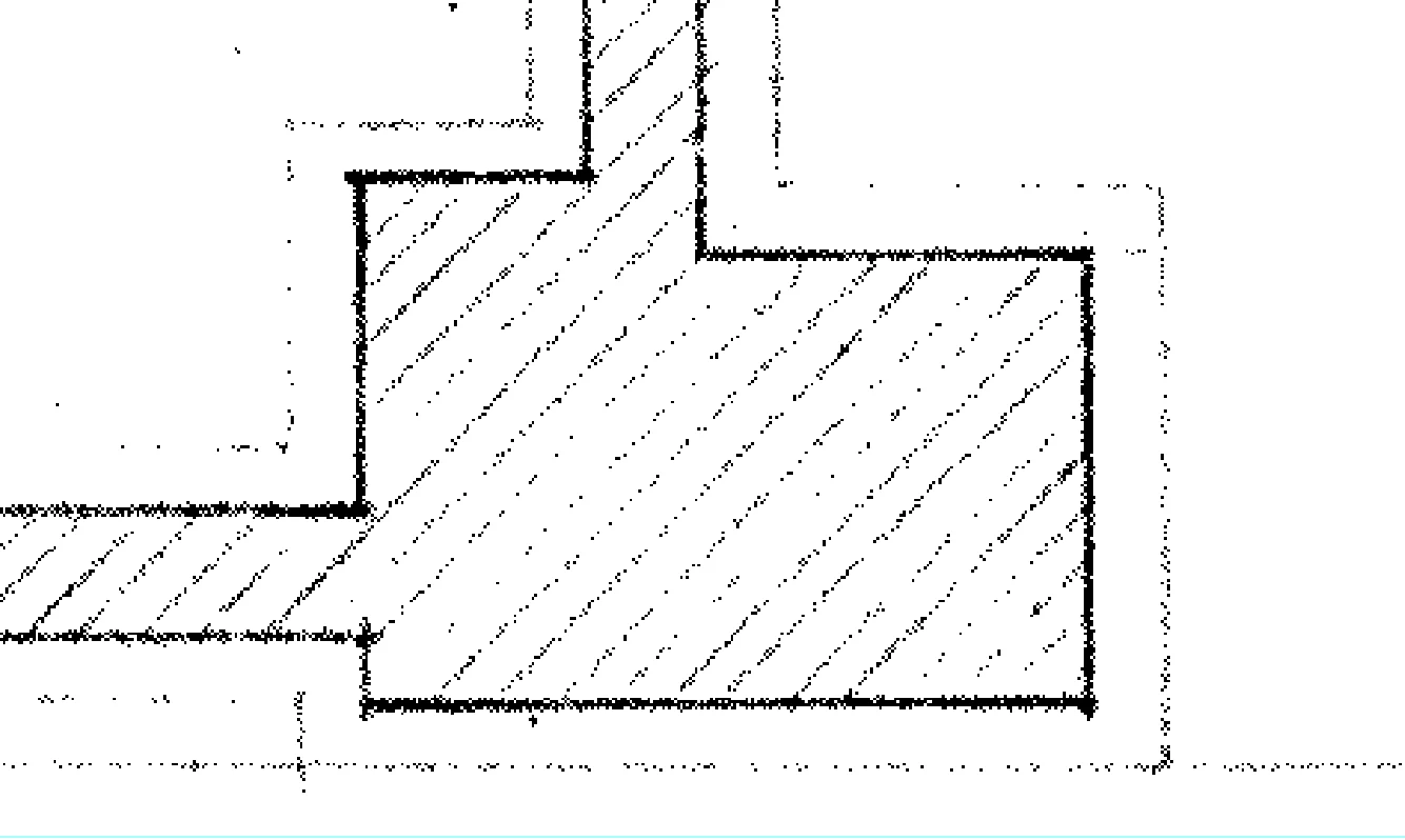

I am working with drawings that need to be at x scale. I have a scanned drawing and it looks like this inside Photoshop:

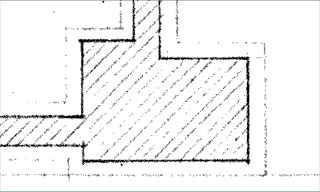

So I am scaling down my image from 100% to 24%. The result looks like this:
Is this normal with raster software, am I having unreasonable expectations?
What troubles me the most is that the original image is a bitmap with only back and white colors, and when scaled I can see gray tones in the pixels. A simple down scale messed up by whole image! I thought up scaling was the problem as Photoshop has to create new pixels out of the blue. I never thought down scaling would result in a quality loss...
I guess I am looking for clarification whether this is normal and nothing can be done or if I am doing something wrong when scaling (which I doubt), but maybe there is a better method to scale images to x size.

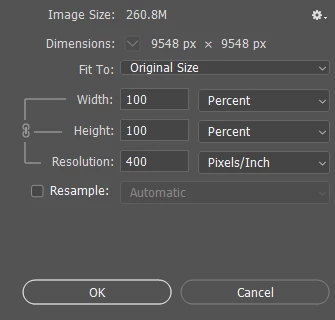

Try this - to resize without resampling as Stephen suggested:
open - image / image size
uncheck 'resample'
set width to 'percent' and enter 24
click OK
it should look fine on the screen now if you view it at 100% / 50% etc, not an in-between number,
[click command 0 to get 100% then command + or - to shift between view values. ]
but what is the resulting PPI number - you may end up with a strange resolution

I resized without resampling to 24% and the resolution went from 400PPI to 1666.667.

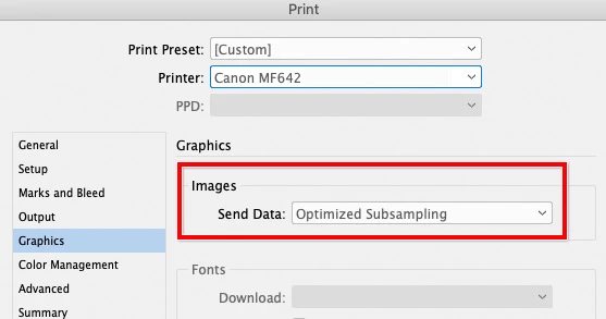

If there is a concern that oversampled images might generate too much data for a print job, you can set InDesign to downsample placed images on the fly, in the Print dialog box. (“Pour them all in and let InDesign sort it out”)

I agree, it is best to first resize without resampling, then evaluate the resulting PPI. Only then make decisions about what to do thereafter.

That is too bad. Here is what I get resampling your first uploaded image:
Perhaps you are viewing at extreme zoom ratio? If you are using Free Transform then you are probably in RGB or Grayscae mode, right?
Check zoom ratio or post screenshot.
