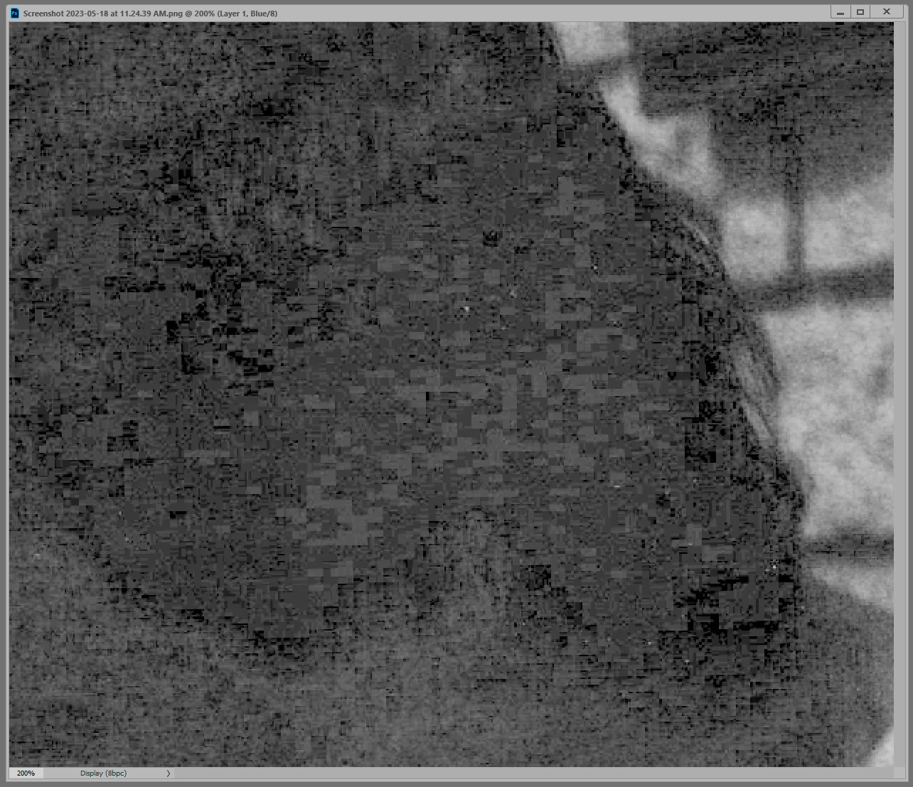

It looks to me like the damage is done earlier. At some point this has been processed at low bit depth and low resolution, and apparently some channel clipping. In other words, it's been very carelessly treated.
This is how the blue channel looks. Not pretty. The interesting thing is that the blocks you see here is not the scanner resolution. The scanner pixels are much smaller scale and become visible if you zoom further in, but this appears to be in the image:
In other words, we're talking manual repair and rebuilding.

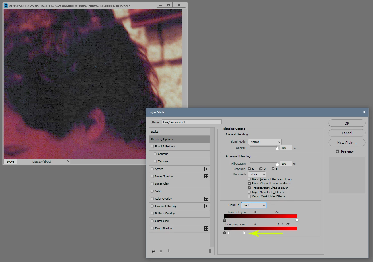

As a quick fix, try a hue/saturation adjustment layer set to 0 saturation, and then use Blend If to restrict the effect to the shadow areas.
LucyLu62Author
May 18, 2023
I will give that a try. Thank you so much!
D Fosse
May 18, 2023
Here's how:
Setting Blend If on the red channel is just because that has the best and most consistent data.
