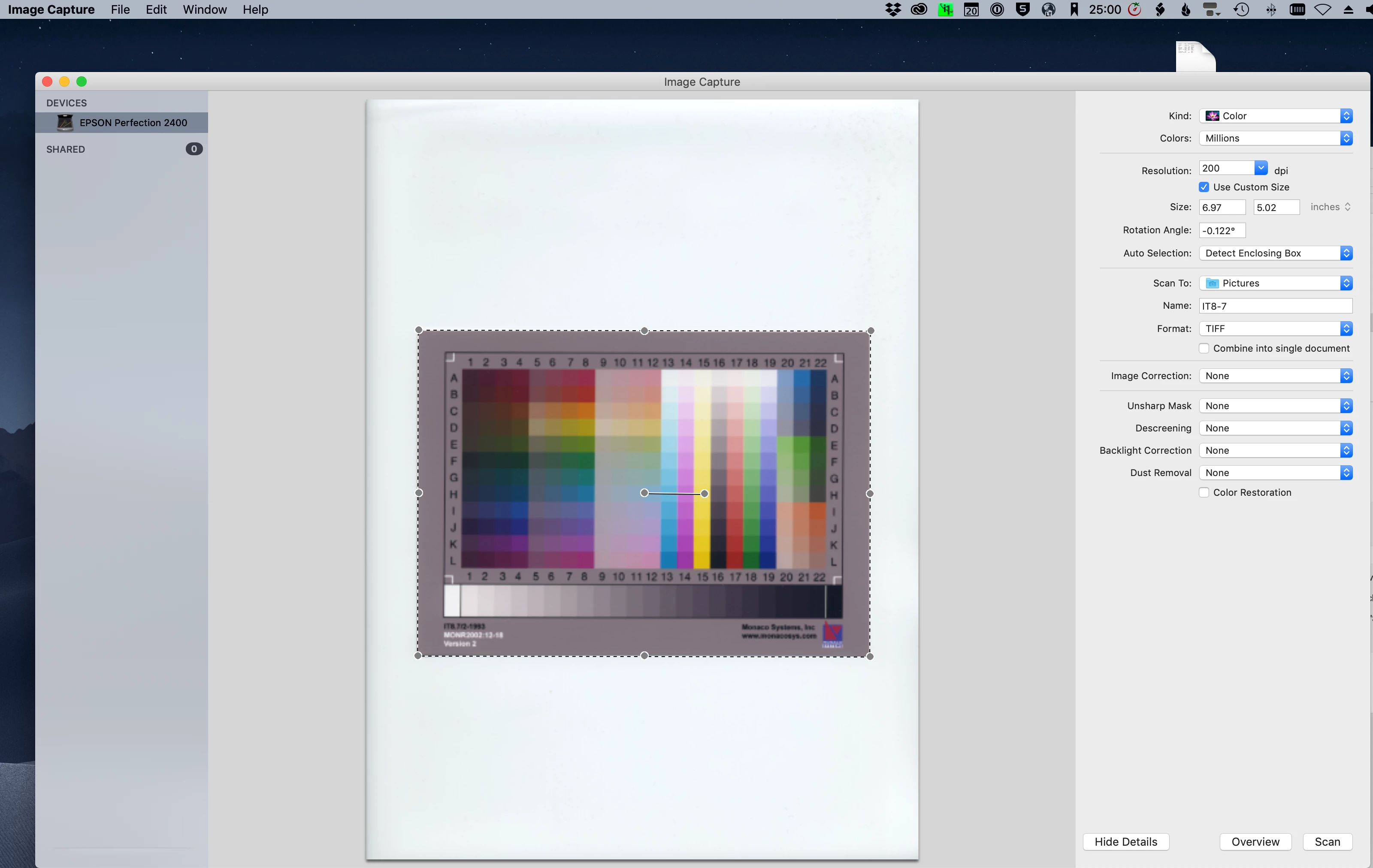

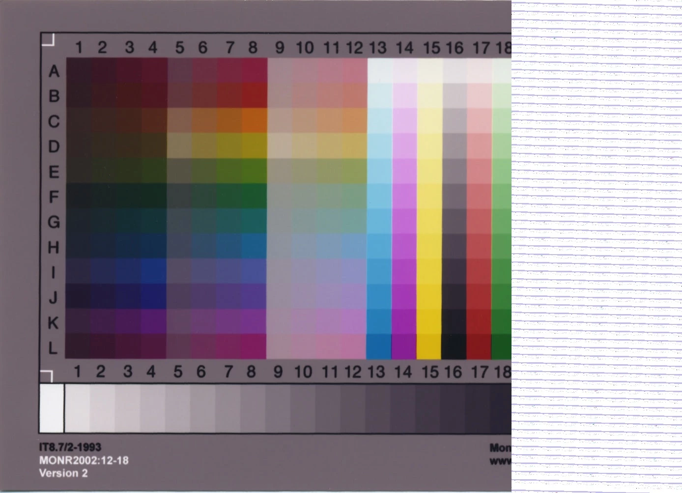

    Could you post some screen shots?
    - The interface with settings when you are scanning
    - The image as it appears after the scan
    March 21, 2019
    Here's a capture of the settings:
    And here's the scanned image (converted to JPEG, TIFF wasn't allowed for posting):
    The scan was done with Image Capture, which Photoshop also uses if I scan from within Photoshop.
