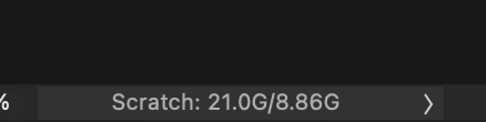

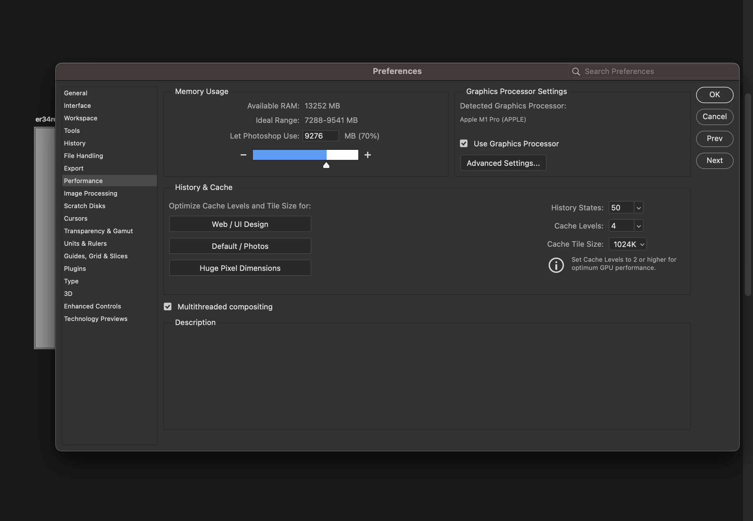

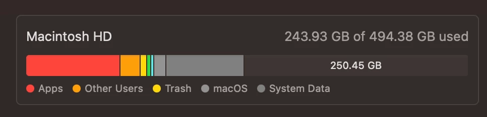

I am currently working on a project that has a final board where we have all followed the same guidelines, though I appear to be the only one with an issue. Even on launch of the file my hard drive gets taken up by 150gb~. I don't know if the measurement on the scratch disk page is honest. The board is 102in x 70 in 300dpi, and while I understand the resolution is enormous, others working on their own come up with a very similar file size  (around 3-6gb), though their scratch only gets up to 30gb potentially. I've already gone to a dozen articles and browsed here for solutions. I have done everything from clearing cache, uninstalling, If I've adjusted too many setting, deleting the preferences, seen if there was an issue with the tmp folder, Clean my mac (ram diagnostics), etc. I don't know what else to do. Thanks for the help!

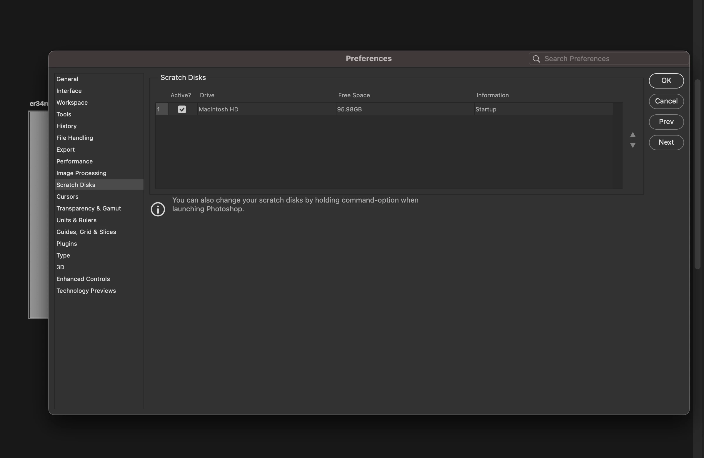

Apparently MacOS reads free space differently than Photoshop. This is a quite common issue, frequently posted here. Do a search and see if there's a solution somewhere (I can't recall).
In any case, Photoshop reports only 95 GB free here. Let's be clear: this is a huge file at 21 000 x 31 000 pixels and 95 GB doesn't even begin to cover what you need here. Depending on history states, layers and other open documents, this is a situation where you will need around one terabyte, quite possibly more.

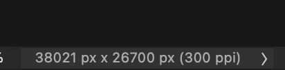

A friend of mine working on the same project had a file resolution of 38 000 x 27 000 and his scratch disks only took 25gb total at most stressed.
Tested the file on my own computer to see if was consistent. The same scratch appears on his computer. We have the near exact same M1 Pro Macbook pro, only their ssd storage is 1tb. Could my file just be corrupted in a way? He formatted his artboards at 1920 x 1080 res, and I prepared mine as 17in x "-" so I could print them on tabloid if I so chose. Are there any other reasons why this could be happening?
