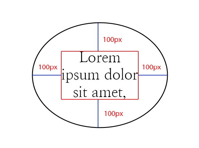

Hello everyone! I'm working with multiple text layers, and my task is to create an ellipse shape below a text layer, which the edges of the ellipse are a fixed distance from the longest points of the text. For example:
The distance varies depending on each job requirement, sometimes it will be 150px, 200px,... so my idea is to put the text layer on a smart object, then enlarge the canvas to double the required number of given pixels, or give that text a stroke equal to that number of pixels then convert to smart object.
The next problem is: how to create an ellipse that fits the canvas inside the smart object? Is there any action or script that does that? I usually use the shape tool to drag from the top left to the right end of the canvas, but because I did it manually, it will make a bit deviation, and I can't type the size for thousands of ellipse for each text layers due to my deadlines.
Hope you guys could give me a solution. Thank you very much!
