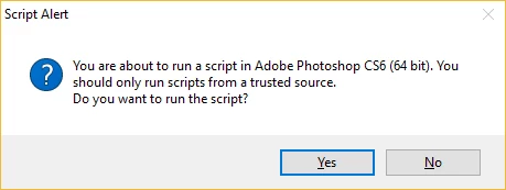

The script runs perfectly. However, the problem is that I don't want any user interaction. I want to be able to run the script from the command line without the user having to click anything. What happens now when I try to run the file from Windows Explorer of the command line is, I get a Script Alert with the following text:
You are about to run a script in Adobe Photoshop CS3. You should only run scripts from a trusted source. Do you want to run the script? Yes/No
Is there any possible way to bypass this message or to answer in the affirmative?

Tom Ruark
May 24, 2008
Put your scripts here:
C:\Documents and Settings\Administrator\My Documents\Adobe Scripts
"A trusted location" and they will run without the message. For photoshop you can put them in the [AppInstallFolder]/Presets/Scripts and they will also show in the File->Scripts menu.

I checked it and in fact, scripts ran directly from C:\Documents and Settings\Administrator\My Documents\Adobe Scripts are not preceded by that protection question.
Problem is that I can't keep there my scripts. So question to users or even Adobe is if I want to have my scripts in other folder than that only one mentioned (in Tom Ruark reply) how to avoid popping up that qestion:
"You are about to run a script in Adobe Photoshop CS6 (64 bit). You should only run scripts from a trusted source. So you want to run the script?" (YES / NO)
Is there a way to turn it off pernamently? My computer is trusted source for me   I don't see reason to press it each time I run some script :/ especially when some of my scripts are part of automation process, and that wouldn't be okey some program stopped because I have to confirm I'm sure I want to run my script...
