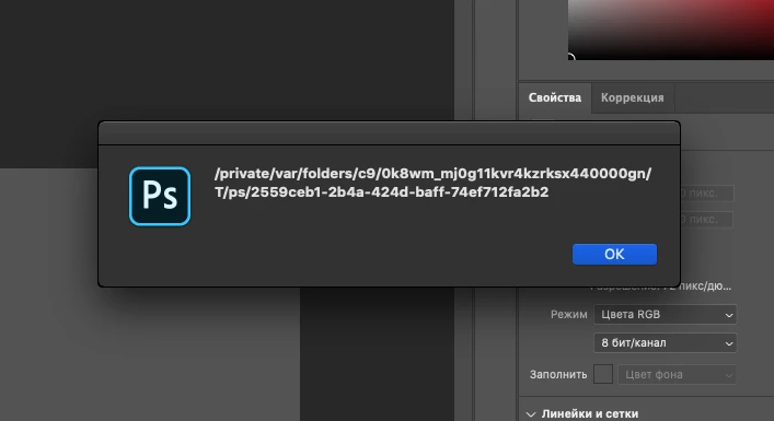

Unfortunately, I can’t install XD on my computer to check that moment (error 191, I communicate with support for several weeks and so far they can’t find a solution for my case), but it seems that the files are opened not from the project folder, but from the temporary directory:
try to transfer the file to photoshop and execute the code
alert (decodeURI (app.activeDocument.path))
- it will show you the path from which the file is open.
