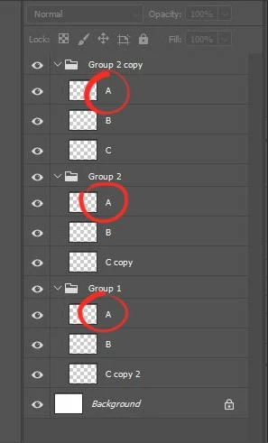

Hello!
Here is my situation, I'd like to be able to launch a script for selecting all the layers with the name A
within my layer stack:
I've already seen several posts speaking about the same question, but for some reason I'm not able to use the scripts who have been shared.  I'm using ExtendScript Toolkit CS5 with Photoshop CC 2019, could it be the reason?
Thanks!

florentl87699272
October 18, 2019
Thank you very much Chuck!
I just tried it and I get the message "there are no duplicate layer names"
Did I make something wrong?
florentl87699272
October 18, 2019
Oh, actually it works fine!!! I haven't selected any of the layers duplicated (like A or B) but
I was on C (which was the only layer with that name - the others were copy C, copy2 C, etc).
THANKS SO MUCH CHUCK!
Chuck Uebele
October 18, 2019
Okay, that's what I thought would make more sense than selecting any layers that have the same name, like all the A's and B's in your example. It would be easier for just one set at a time.
Chuck Uebele
October 18, 2019
Since it looks like your file has several different layer names that are duplicates, how to you want to select just one set of them - by using the current selected layer?
florentl87699272
October 18, 2019
Well, the idea would be to be able to select all the layers with the same name, so that I can move them into the same folder at the same time (the file I'm working on currently contains hundreds of layers, and it's impossible to select rapidly all the layers with the same name).
Are you saying it sounds impossible to do that script (sorry I'm not a programer)?
I tried to create a script manually on Photoshop but it selects systematically the layer A at the bottom of the stack and only this one.
Thanks for your help!
Chuck Uebele
October 18, 2019
No, it's possible to get all layers with duplicate name, just wondering what exactly you want.
