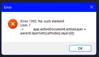

Hey guys! I have this script that I found here in the community and I've already tested some others. They all close groups containing layers, but if the group is empty, the script stops.
Is there any way for this script to work even on empty groups? My client uses an automation and needs all groups open.
Thanks if anyone can help.
Ther script i am using is this:
// Expand ALL layer groups/sets
openAllLayerSets(app.activeDocument);
function openAllLayerSets(parent) {
    for (var setIndex = 0; setIndex < parent.layerSets.length; setIndex++) {
        app.activeDocument.activeLayer = parent.layerSets[setIndex].layers[0];
        openAllLayerSets(parent.layerSets[setIndex]);
The error i get:

Jan 16, 2023 5:04 PM UTC
Expands even empty groups.
        if (parent.layerSets[setIndex].layers.length) {
        } else {
            parent.layerSets[setIndex].artLayers.add()
            parent.layerSets[setIndex].layers[0].remove()
If this is not necessary, then it is better to heed the advice of the @c.pfaffenbichler

Worked perfectly, Thank @jazz-y

Jan 16, 2023 4:48 PM UTC
The easy way would be wrapping the affected part in a try-clause.
