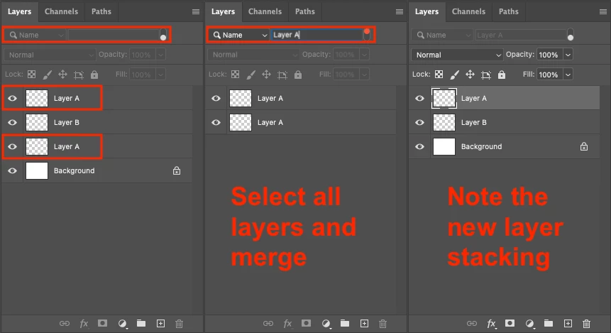

Stephen Marsh
February 21, 2023
The layer name filter is often useful, which is the manual equivalent of scripting and the manual steps are not that taxing.

Stephen Marsh
February 22, 2023
quote
thanks, this of course solves the problem if i wanted to do it manually, but i want to automate it
By @jack284003085p35
You only mentioned the need to do this for 2 sets of named layers.
I understand, however, there is a cost/benefit to this.
It would take approx. 1 minute to do this manually. The manual steps are not onerous. Multiply this however many documents need to be processed.
Compared to the time spent by a volunteer developing the script.
