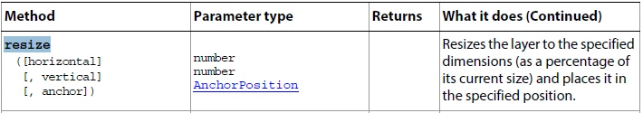

var x = 120; // new width in percent
app.activeDocument.activeLayer.resize(x, 100, AnchorPosition.MIDDLERIGHT);

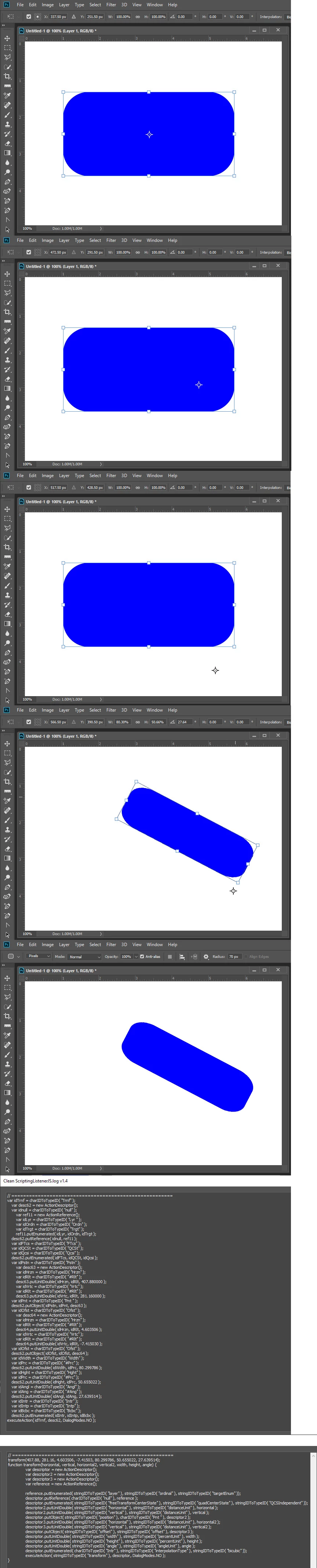

So Photoshop DOM Layer Resize is more or less a subset of Layer Transform.  With Photoshop  Transform UI and Adobe's Scriptlisener Plug-in you can actually program a full layer Transform into a Photoshop Script.  Code a Transform function for layers.

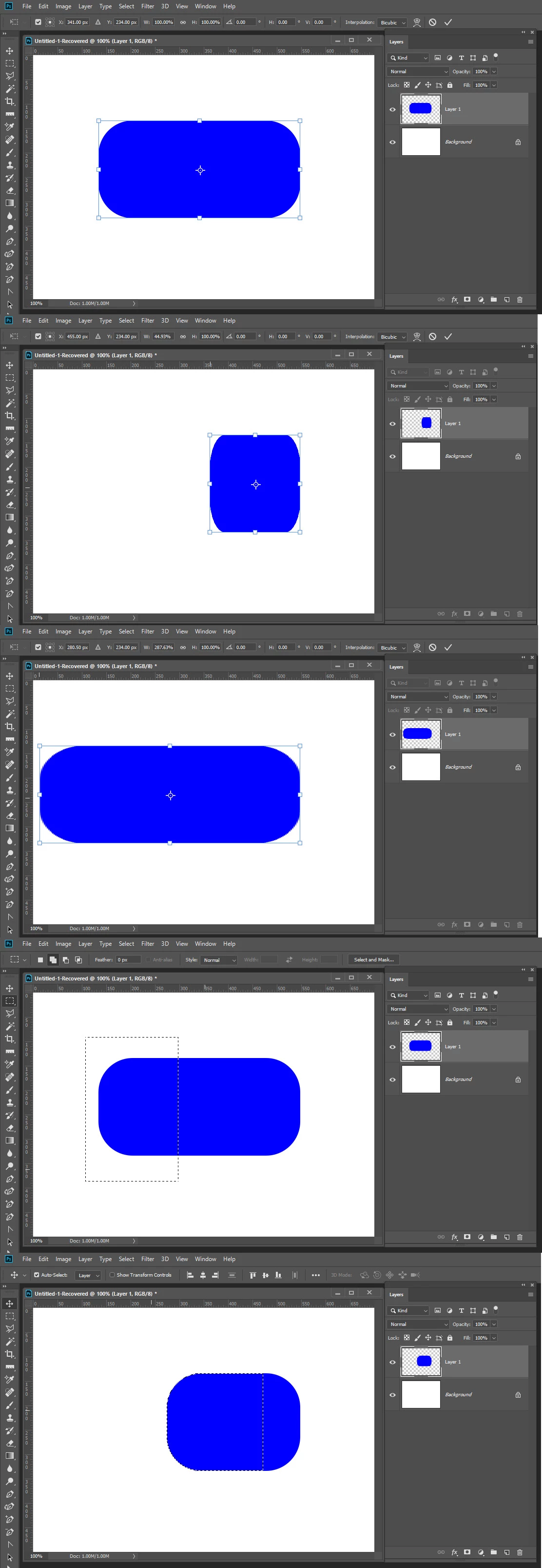

If you know the width or height you want, the layer you want resized  and do not mind the rounded corners distortion you should be able the script the layer resize.  If you want you shrink it  the selection and move would be more involved as would growing it wider or taller.

You are doing a layer resize. You may be able to use action manager code to do it like you can using Free transform and chaning one side position. Or you may need to do it in two steps  one resize the layer to the size you want and a second step to align the layer to the position your want.

If its is a solid color fill Ctrl+T Free Transform can do the howevet the roundered cornor will distort. However you can select half of it abd nove the inward to shrink it withour distortion.
