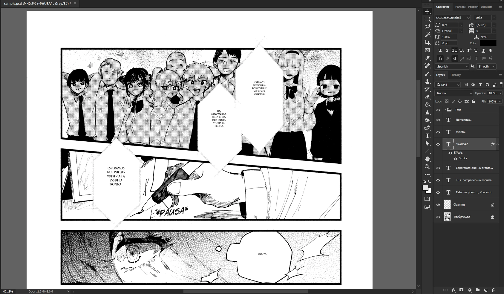

Heres a sample of what im working on, most layers are 5.87-6.87pt, while others are other sizes, so I'm trying to make all the text layers sizes to be rounded up, so I can work on them properly, because I dont want to change every layer size manually 😔
And yes, while most text layers have different sizes between each other, the individual layers have a consistent size.
@Iuigidesu
Can you show a screenshot that includes your layers panel?
