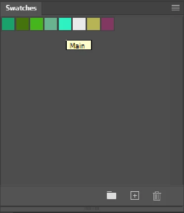

Hello, is it possible to select foreground color from the swathes panel by color name , using script?

Sorry I couldn't answer earlier. This isn't exactly what I needed. I guess my explanation wasn't that good.
But I found some scripts on the forum and learned that you can name the swatches with their hex values ​​and then paste those values ​​into the foreground color.
Here is the script . If foreground color is black or white the script will switch only these colors. If it is another color then it will switch between three colors.
IT WORKS CORRECTLY ONLY WITH AN EMPTY SWATCHES PANEL!

Sorry I encouraged your hopes – I hadn’t considered that Swatches are a bit of a clunk in EXTK-Scripting.
Maybe someone with UXP-Scripting-chops can offer a solution …
In ESTK-Scripting one can certainly check if a Swatch of a certain name exists, but using its color values would, as far as I can tell, necessitate reading the aco-data.
Hopefully someone else has a better idea.

The main script I was trying to make was switching between three foreground colors (some color, then white and then black). For example if the current foreground color is green, I need the script to somehow remember that color, then when I rerun the script it should switch to white, then black and then back to green etc. If the current color is black or white then the script should not remember them. The solution I came up with was to make a script that puts that color in the swatches panel, gives it the name "Main" for example, and then take it from there. If I changed the foreground color, for example from green to red, and ran the script, it should remove the green and add the red to the swatches panel. the background color should not be used. Hope I explained it clearly) Maybe there is a simpler solution?

c.pfaffenbichler
February 21, 2025
What do you have in mind?
A dialog with a text-entry-field, a dropdown list, …?
Or is the name to be evaluated from a layer’s name or …?
Zipo4323Author
February 21, 2025
Thanks for the quick reply! If there is a color with some name ("Main" for example) in the swatch panel,  I need the script to select it as the foreground color. Without dialog boxes, drop-down lists, etc. Sorry for my English if I made a mistake.
