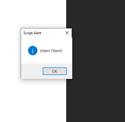

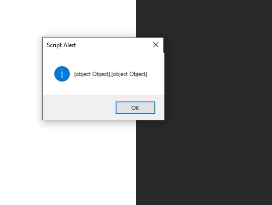

So I need to generate a big number of images from 1 image (like lottery tickets) that come from a set of numbers I have in a JSON file.
I have everything working, I just can't get the script to properly work with the JSON itself... For example, if I just run this code:
var data = [{"apple":{"size":5,"taste":4,"color":7}},
{"orange":{"size":8,"taste":4,"color":8}}]
alert(data);
alert(data[0]);
What I get on photoshop is just [object Object], instead of the data I put in the JSON object.
What I am doing wrong here, can anyone help me?
Correct answer Kukurykus
In both alerts use at end:
.toSource()

Kukurykus
KukurykusCorrect answer
September 30, 2021
.toSource()

September 30, 2021
Yes, "toSource()" and "toString()" and "eval" are your friends. You can also dump data into a text file and inspect that, which has the added advantage of giving you a de facto log file.
September 30, 2021
Read this, which quotes the manual Script Alert - Title - Alert Box
alert is NOT a data formatter or a data dumper. It simply displays a string. So your non-string object is converted by normal JavaScript rules to a string object like "[object Object]".
