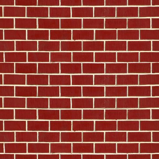

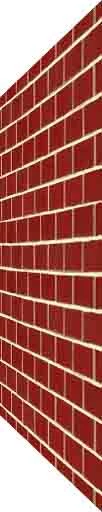

I will take a look at that lengthy script that was posted, but being a javascript noob, it may take some time to get it to do useful things.  I just want to add a perspective transformation to a brick wall to make it look like 3D.  Like this:
Before:
After:
I can do the squash-resize in AppleScript no problem, but the simple perspective transform appears to not be supported.
I investigated the scriptlistener plug-in, but that appears to not be available in my PSE v9 package (?...)  I could not find it in my file tree.  Is there anywhere else to get that plug-in?  Would it work on PSE?
