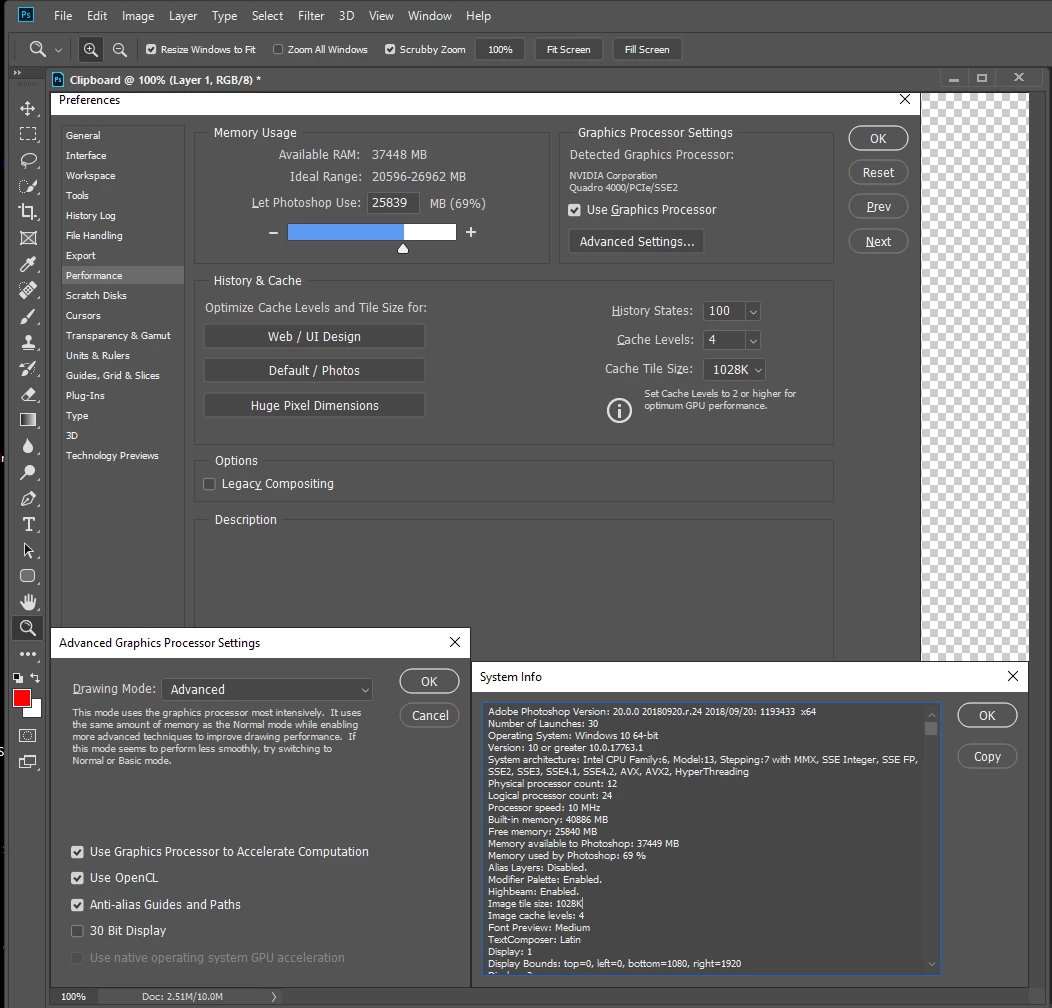

JJMack
November 3, 2018
I can check scrubby Zoom with these settings.

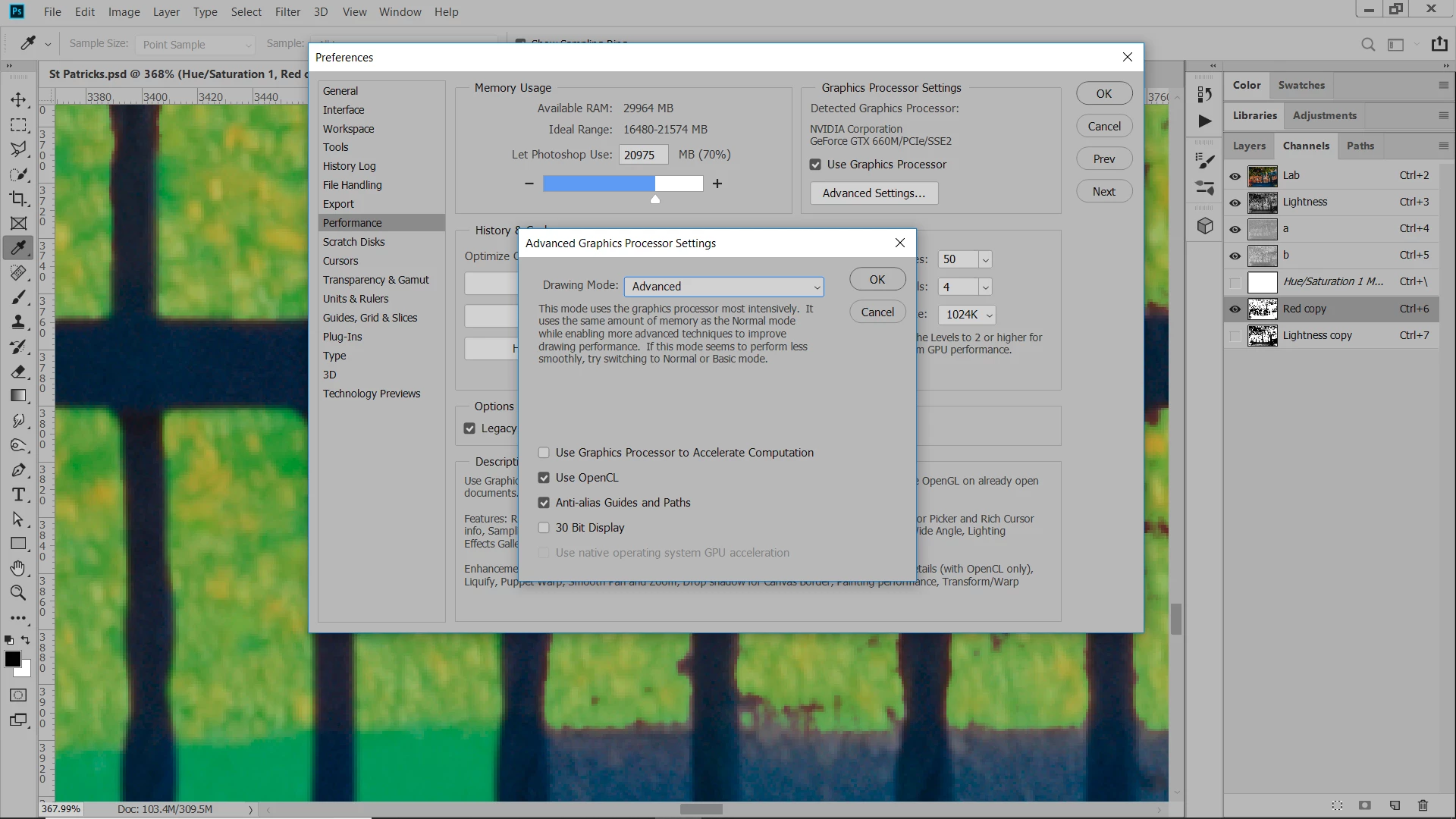

JJMack
November 3, 2018
Same settings here on Performance and Graphic Processor Advanced Settings.
But still don´t work (works on a Photoshop 2015 version)
