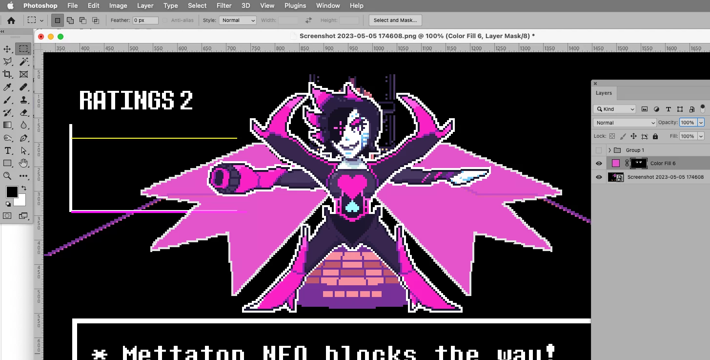

The pictures are from a friend who has a mod of Undertale. (the bits and pieces mod)
I have attached the screenshot from the game I got the sprite from and two screenshots of my photoshop file
Photoshop screenshot with everything
the green background is just so I can see the white outline of the sprite, that is unrelated
the grid is also unrelated to my issue, I have that set up for something else
layer 3 is the rest of the sprite that isn't translucent so I don't have this issue
Layer 5 is the wings (the part I was talking about)
layer 2 (hidden) is my backup in case I cant fix this issue, it is pretty much layer 5 but without the gradient or background artifacts
Photoshop screenshot, layer 5 and background only
As stated, only showing the problematic layer (the more full screenshot but with layer 3 hidden, so I didn't feel the need to show the layer panel again)
Game screenshot:
you can see the background that is showing behind the wings, I am constantly taking this in and out of photoshop to fix and change things, but it is not in this file at the moment (but could easily be brought in again)
My friend took this screenshot (and like 100 other unrelated ones) for me to do this project
so ideally I would like to see what the wings would have looked like if they were full opacity rather than translucent and with the background showing behind

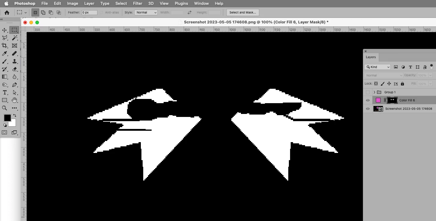

Seems the Magic Wand Tool with Anti-alias unchecked could be used to create a Selection/Layer Mask.
