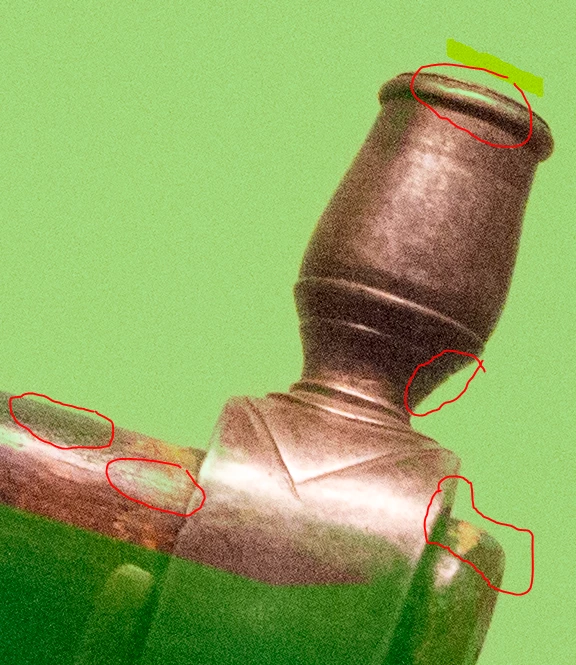

I followed Scott Kelby's tutorial, but he's got hair on a light background. I'm applying this to museum objects in cases, masking whatever's behind them; I try to maximize contrast first in Lightroom before bring the image into Photoshop. Still, I'm finding that instead of simply finding the borders and excluding everything on one side of the ants, the tool is deleting pixels in the color range on both sides. I'm winding up with semi-transparent ghost areas:
I have to keep going back with the brush tool to make these areas "solid" again. How can you select tolerance or sample area size in Select and Mask mode to minimize this?

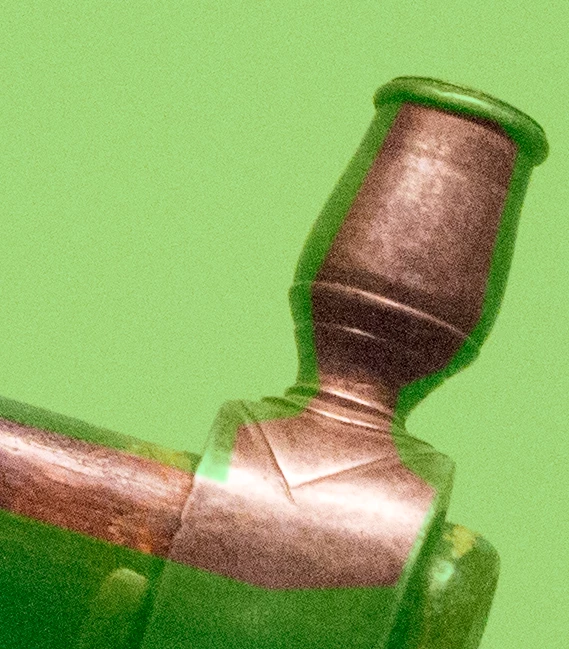

Hi
Refine edge is the wrong tool. It is for soft edges such as fur and hair.
This took about a minute with the pen tool to draw a path around the object then click where shown to add a vector mask from the path. No more brushing or refining required.
Dave

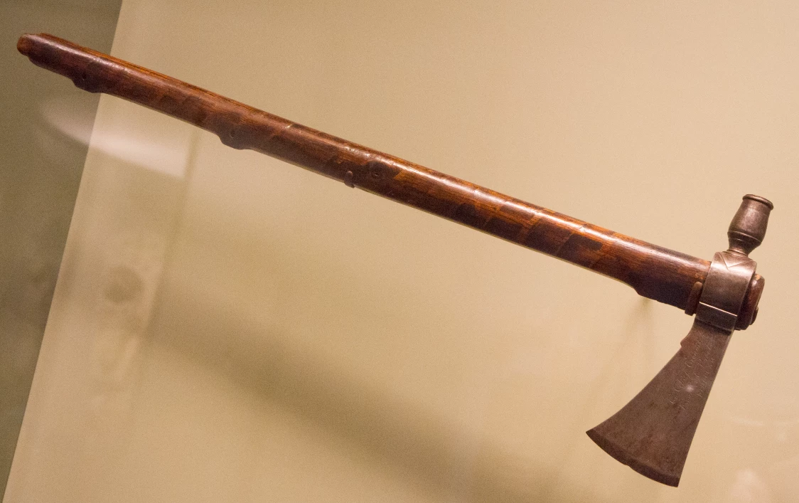

OK, so here's the original axe:

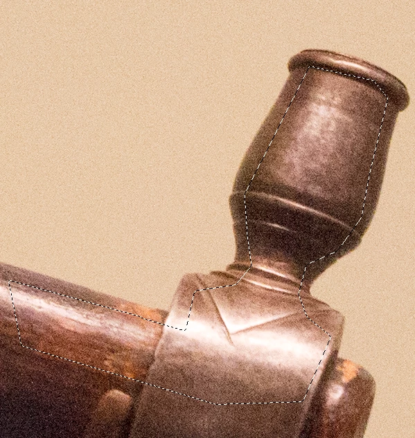

I used the polygon marque to outline--

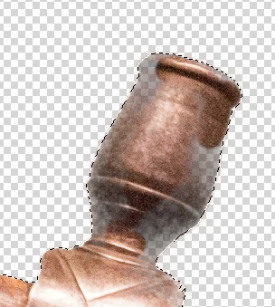

--then went into S&M mode--
--and here's after some refining, with the brush set on full hardness, spacing 25%.
I can understand not getting everything at the top, since that's where the shine is. I'm more troubled by the areas along wooden shaft, where at first it looks like I've got a solid edge, but you can see pixels have been erased even well inside of where the marque was. If I put a contrasting background behind the ax afterward, it will show through. I'm wondering if the noise is a factor (ISO 3200).
