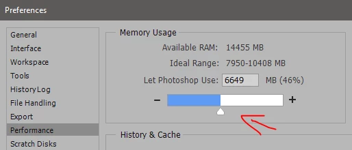

jaker83593459
August 20, 2018
I have too had this problem across Photoshop CC for years. I've found that adjusting the Performance settings especially the percentage of memory you let photoshop use (my sweet spot is around 52%) helps a bit.
But it's still very, very slow and using the old refine edge seems to be the best workaround.

reducing performance helped a great deal for me
