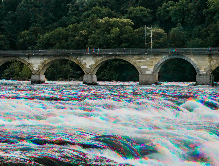

There's a trick I did with GIMP years ago to combine 3 aligned photos with moving water where I take the Red from one, Green from another and Blue from the 3rd and merge them back into a single RGB image with psychedelic effects in the moving water but the static parts look normal.

Cool - that's exactly the effect I managed with GIMP.
Thanks very much for helping a PS n00b
I can go on from there and try different things now (eg working on the water area without getting the RGB effects on the people on the bridge). It was simpler than I thought but i would not have found that option without your help.
Cheers! Tim

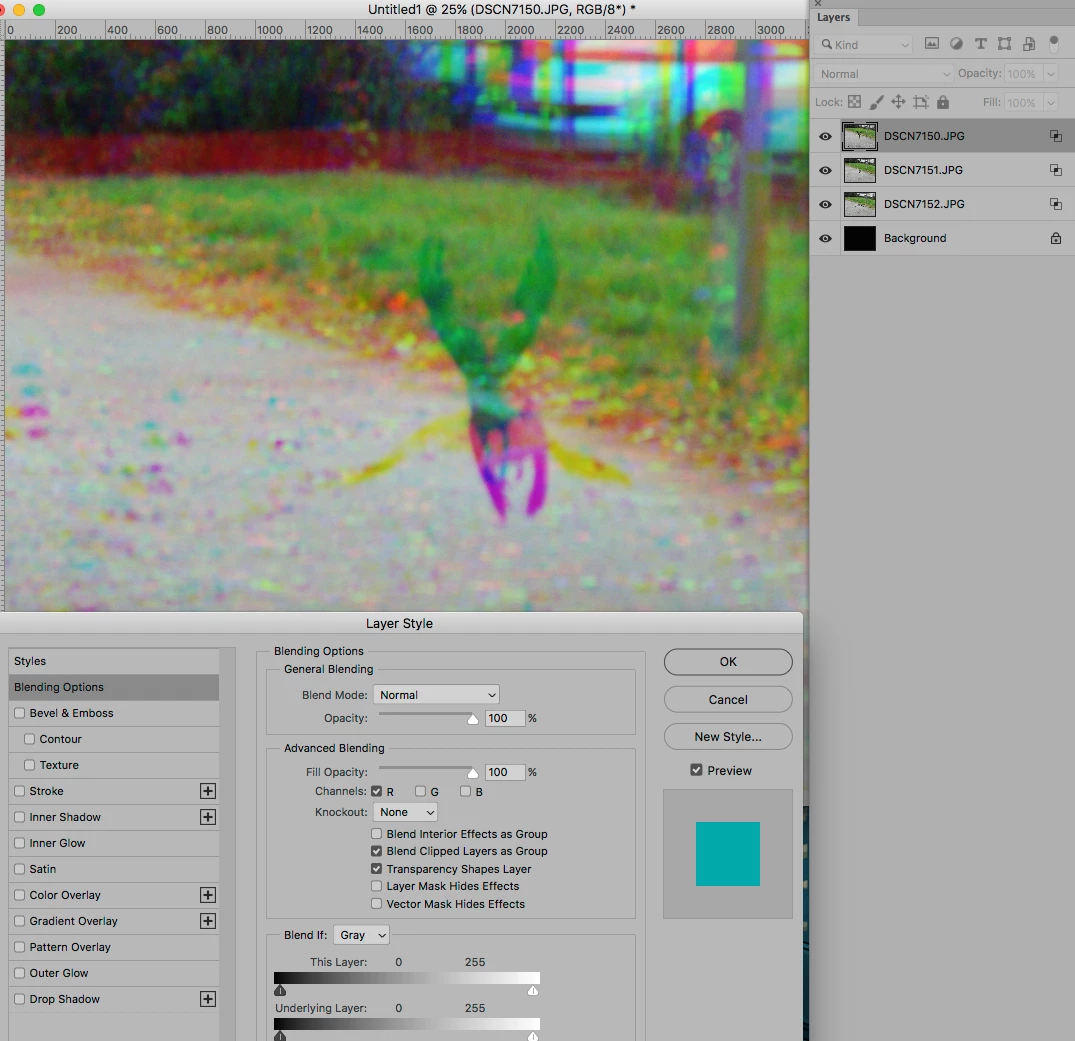

You could duplicate one of the Layers, sett it to affect all three Channels again, apply a Layer Mask (Layer > Layer > Mask > Hide All) and then paint with white on the Layer Mask where you want that Layer to show.
c.pfaffenbichler
August 18, 2019
You can use the Blend if-Settings.
