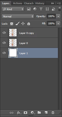

I have the following layer setup and here is what I want to do via a script
1) Select Layer 1 and Layer 0
2) Align Layer 0 to left of the canvas
3) Select Layer 1 and Layer 0 copy
4) Align Layer 0 copy to the right of the canvas
Is this even possible via script? Document sizes vary

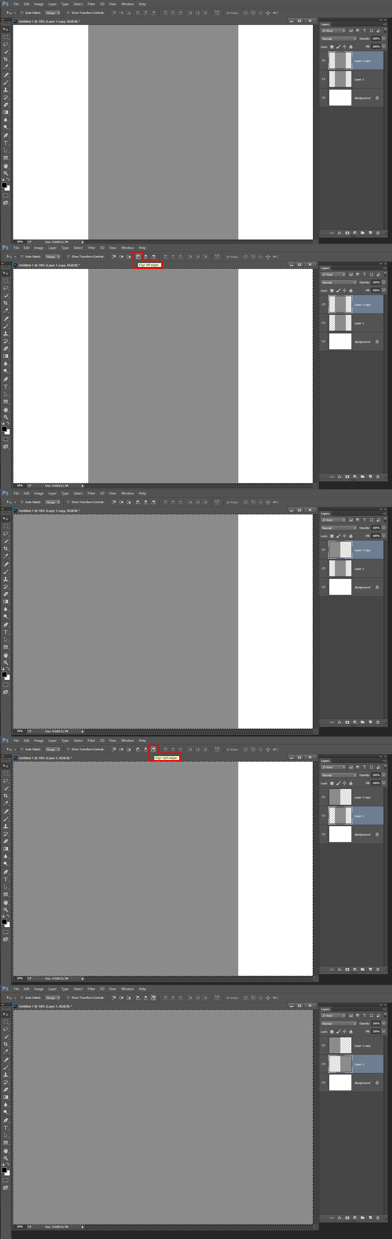

If you look at the script I posted it does the select all and the two align steps to allign the current layer.  All the four charter alignment id are listed in the  code. all you need do is target the layer you want to align. it should look something like this
var savedActiveLayer = app.activeDocument.activeLayer;  // save current adtive layer
app.activeDocument.selection.selectAll();                          // select all
// Left('AdLf'); Right('AdRg'); Top('AdTp'); Bottom('AdBt'); Center Horizontal('AdCH'); Center Vertical('AdCV');
add code to target layer 0                                                  // activeDocument.activeLayer = layers 0
align("AdLf");                                                                    // Align to selection Left Side
add code to target layer 0 copy                                          // activeDocument.activeLayer = layers 0 copy
align("AdRg");                                                                  //Align to selection Right  Side
app.activeDocument.selection.deselect();                           // deselect
app.activeDocument.activeLayer = savedActiveLayer;        // restore current layer

It easy to do manually you would automat it the same wat with avd action or script.
With the move tool active you select all to activate the alignment icone int the tool option bar
Targer one layer and use the align layers to the selection left side
Target second layer and use the align layers to the selection right side
you can also write a script to expand the canvas to house a layers content and align the layer to the added canvas. for example
http://www.mouseprints.net/old/dpr/pasteClipboard.jsx
