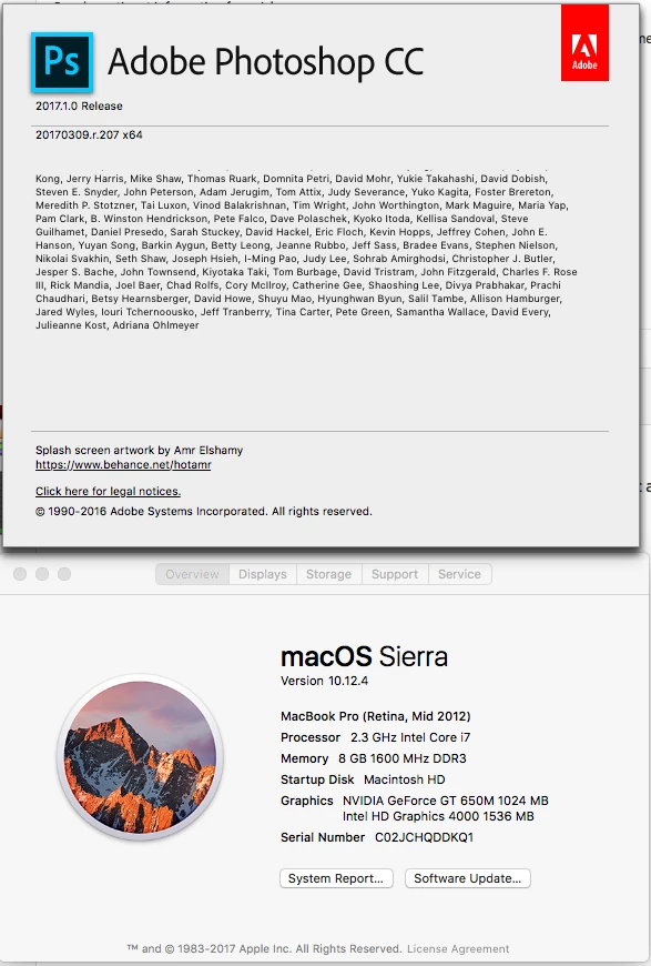

JJMack
April 6, 2017
Capoman  wrote
In the past you could select multiple objects that were in close proximity now it is not possible it's almost as if when something is selected there is a 20 pixel padding around the object not allowing you to select items that are within close proximity this is driving me crazy and also if you try to select it it flips the rotation icon and now you have to cancel the action in order to try again - WTF this is crazy I work pixel by pixel and this is a nightmare - any thoughts?
What are you using that add a 20 pixel padding are you feathering what you select  or blurring the selection?
Supply pertinent information for quicker answers
  • The more information you supply about your situation, the better equipped other community members will be to answer. Consider including the following in your question:
  • Adobe product and version number
  • Operating system and version number
  • The full text of any error message(s)
  • What you were doing when the problem occurred
  • Screenshots of the problem
  • Computer hardware, such as CPU; GPU; amount of RAM; etc.

With the More Tool selected and ctrl-alt-shift pressed I can click-select multiple Layers without problem, could you provide your file for testing?

Please explain what exactly you are doing, post some screenshots with the pertinent Panels visible to illustrate.
Are you sure the Layers do not have »stray pixels« or are poorly clipped so that there may be near-invisible content within the »20 pixel« area you describe?
