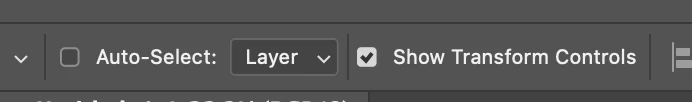

Hi @LesToil100 check your move tool settings - do you have Auto Select layer checked?

Kevin--I very much DID have it selected!! Problem solved! Thanks so much!
