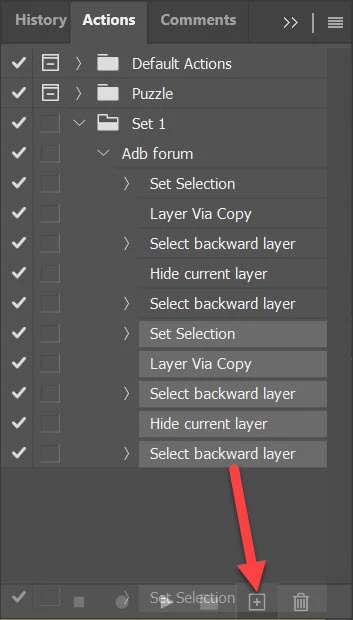

You could automate using action. It will be easier if you always have same amount of layers in each file that you want to automate.
Here is the process:
  • Start recording action, of course.
  • Draw or create selection. If you have same document dimensions always do not worry about Ruler and Measurement unit, thats probably case I just want to draw your attention that Ruler and what Measurement unit is set can play role when recording action.
  • Press Ctrl + J, it will create new layer by copying selectedd area. I will skip layer naming because its not clear whether you want that.
  • Press Alt + [ to go back to layer from which is copied selection.
  • Press Ctrl + , to hide layer if thats what you want, otherwise skip this step.
  • Press Alt + [ to go to layer below which is next layer with content to select and copy in the layers stack.
  • Select and drag all action steps onto icon new page to duplicate them.
  • Repeat as many times as you want for any number of layers in the document or repeat 5 times and run action multiple times until you get it how things work.
Here is example action https://drive.google.com/file/d/1GQhJG5scMqORp2Oc0KfAApFxqMCzfz6g/view?usp=sharing. Run action in the document which is not for production but rather for testing purpose. Before running action ensure that you have at least 5 layers plus Background or any other layer at the bottom (total 6 layers) and that top most layer is selected.
