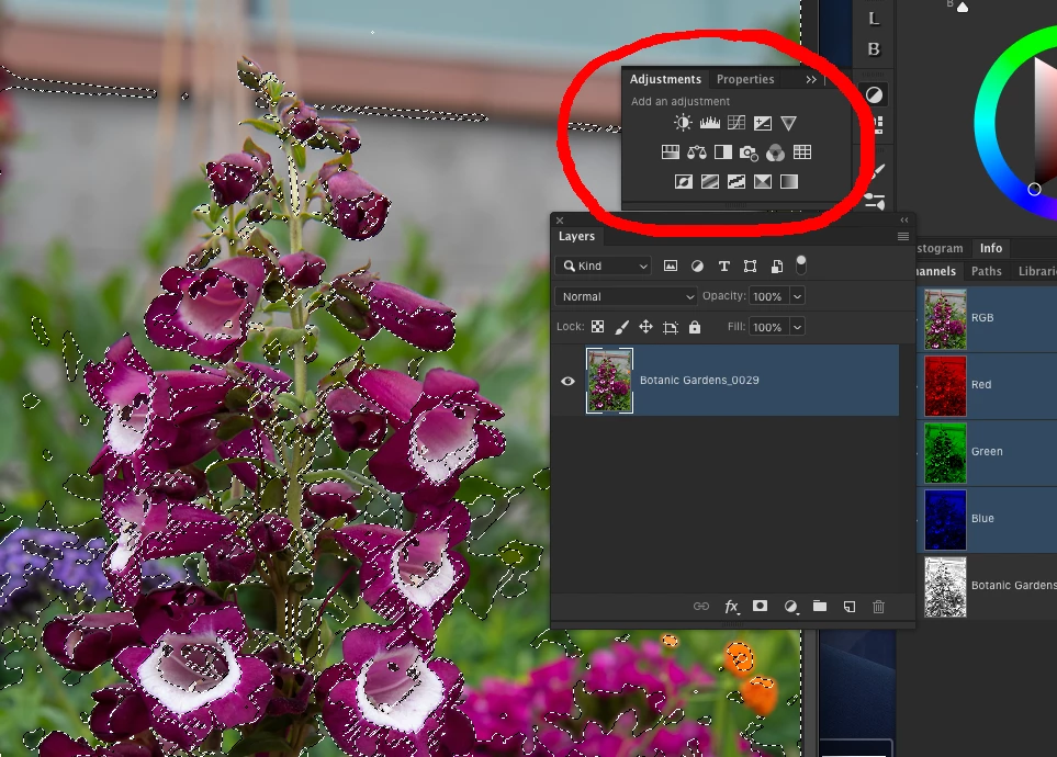

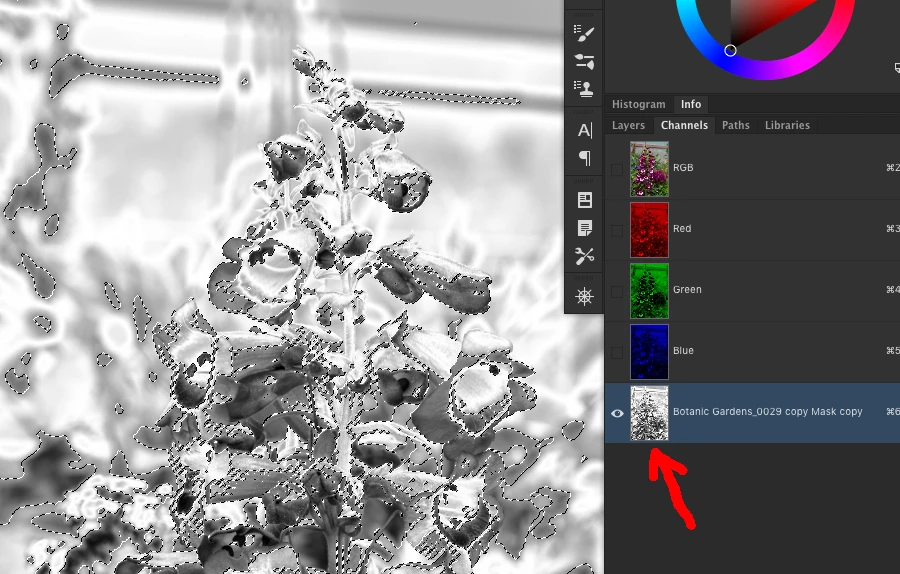

    I'll show you real fast how it's done basically. i have 1 luminosity mask created and saved in my channels panel. (most of the luminosity mask creation plug-in's will create them here...)
    1.     CMD+click on the mask in the channels panel. this will show up as the marching ants selection on the image.
    2.     Switch over to the layers panel
    3.     It should now show you the marching ants on your actual image.
    4.     Click on whatever adjustment  you are wanting to work with in the Adjustments panel. for this example, I chose curves.

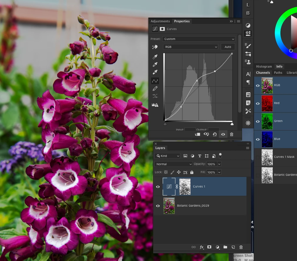

    5.     Once you click on one of the adjustments you want, it will appear as a layer with the mask already there.
    Now you can adjust away and it will only go where the mask allows it to go.

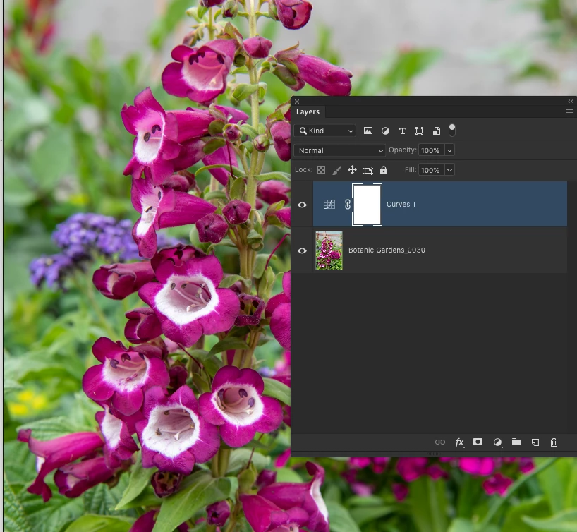

    1. Image with the adjustment layer on, but with a full screen mask

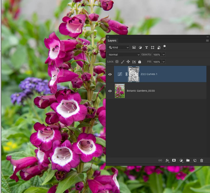

    2. After selecting the mask in Channels, I filled the mask with black on the adjustment layer Edit > Fill > choose black in the drop down.

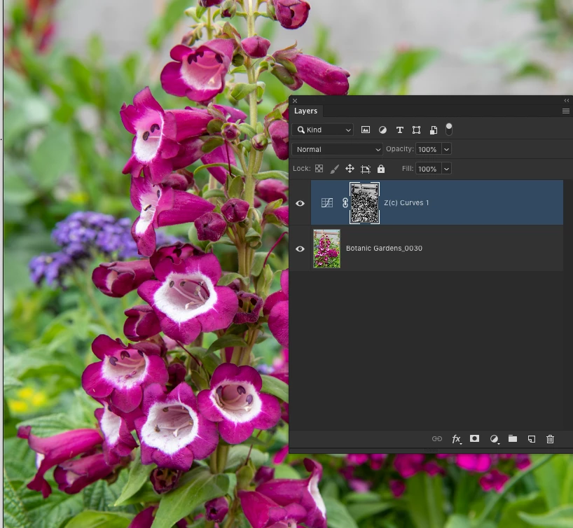

    3. Now just invert the mask so it works how you would like the selection adjusted. Hit CMD+i or Using the menu at the top, Select > Inverse.
    either of these should help you to get the Luminosity mask applied to your adjustments.
