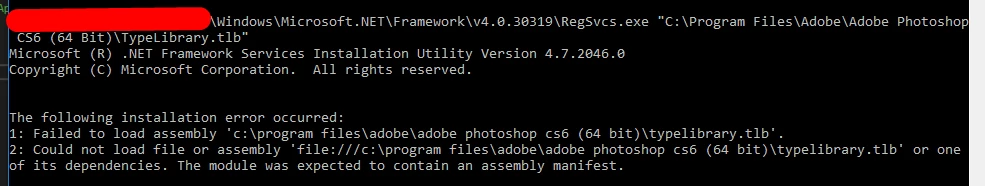

Thanks Tom for the reply, quick follow up:
1. Does this global get assigned to the application (Can I just set up the suit at start up and call it from an external app)? And if so, off the top of your head do you know the function to set a global in PS C++? I won't be using it for this example, I just need to set a global to tell PS that it has a open file from an external app so I can call back to the app a refresh when the user saves a file.
2. I'm trying OLE in c# currently, late binding seems to work perfectly:
   dynamic app = Activator.CreateInstance(Type.GetTypeFromProgID("Photoshop.Application", true));
         var doc = app.Open("D:\\a.psd");
Though I would like access to the library; So I am trying to use the Photoshop COM Assembly, when I do I get an error (No interface supported):
    Photoshop.ApplicationClass app = new Photoshop.ApplicationClass();
    var doc = app.Open("My Image Path);
So I'm trying to register "TypeLibrary.tlb" manually but it's not working for me:
Thanks for any help!
