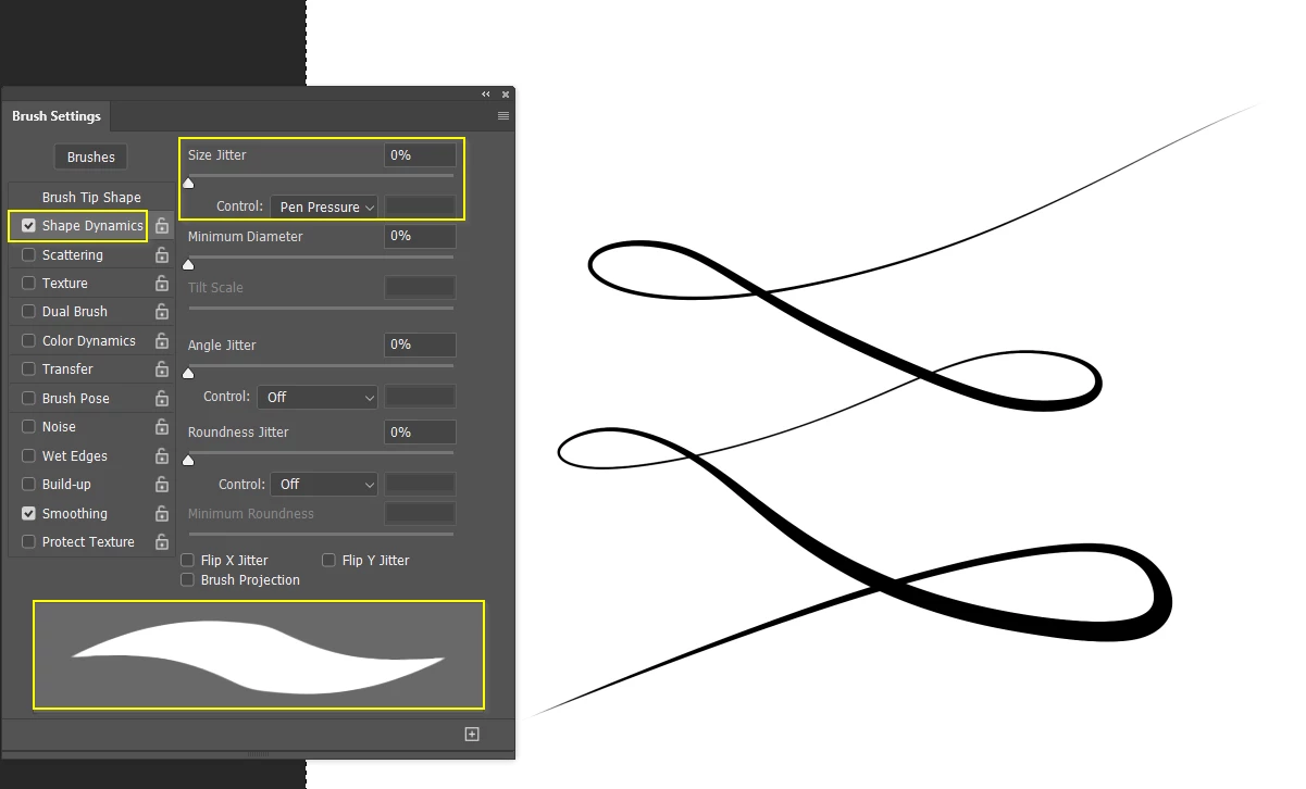

If it is working OK, and you set Size Jitter control to Pen Pressure, and make some brush strokes, then the preview in Brush Settings will show a tappered stroke at the bottom of the panel, and you'll be able vary line thickness when using the brush.
