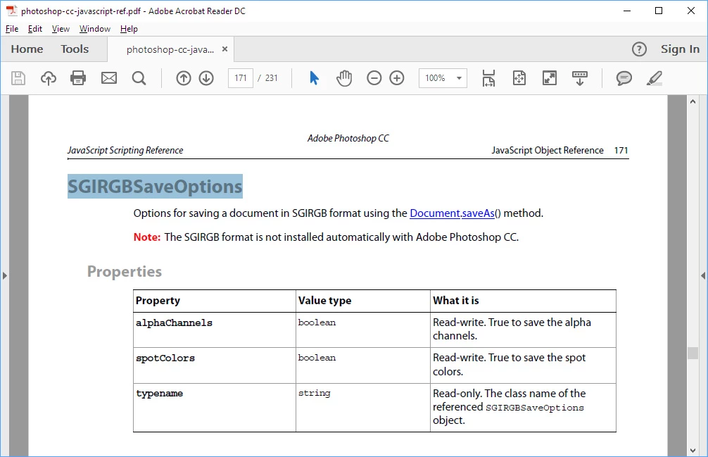

I thought saveoption.typename was read only you seem to set that to false? I would also think that the file extension would be something like .sgi not .rgb but then  I have not installed the plug-in so I do not know the list of possible file extensions.

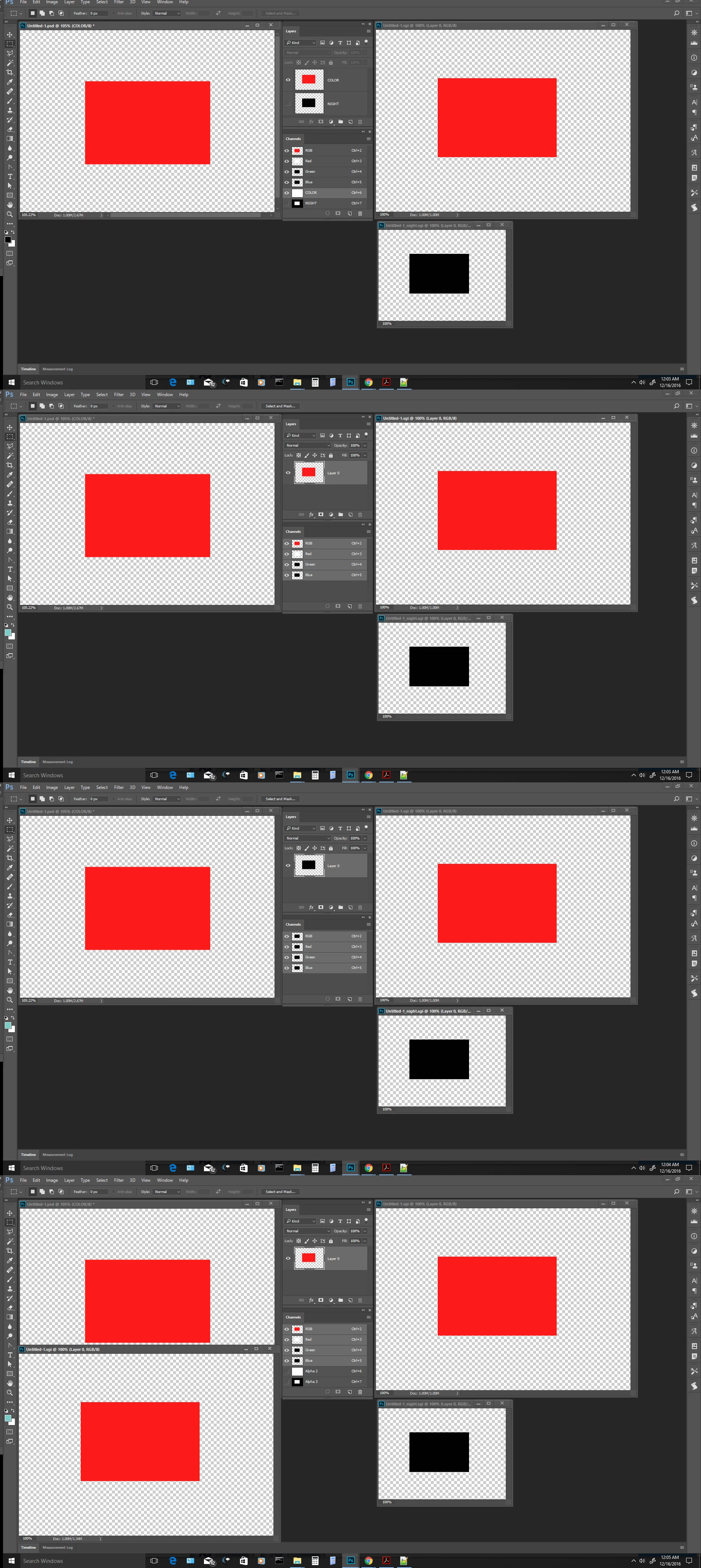

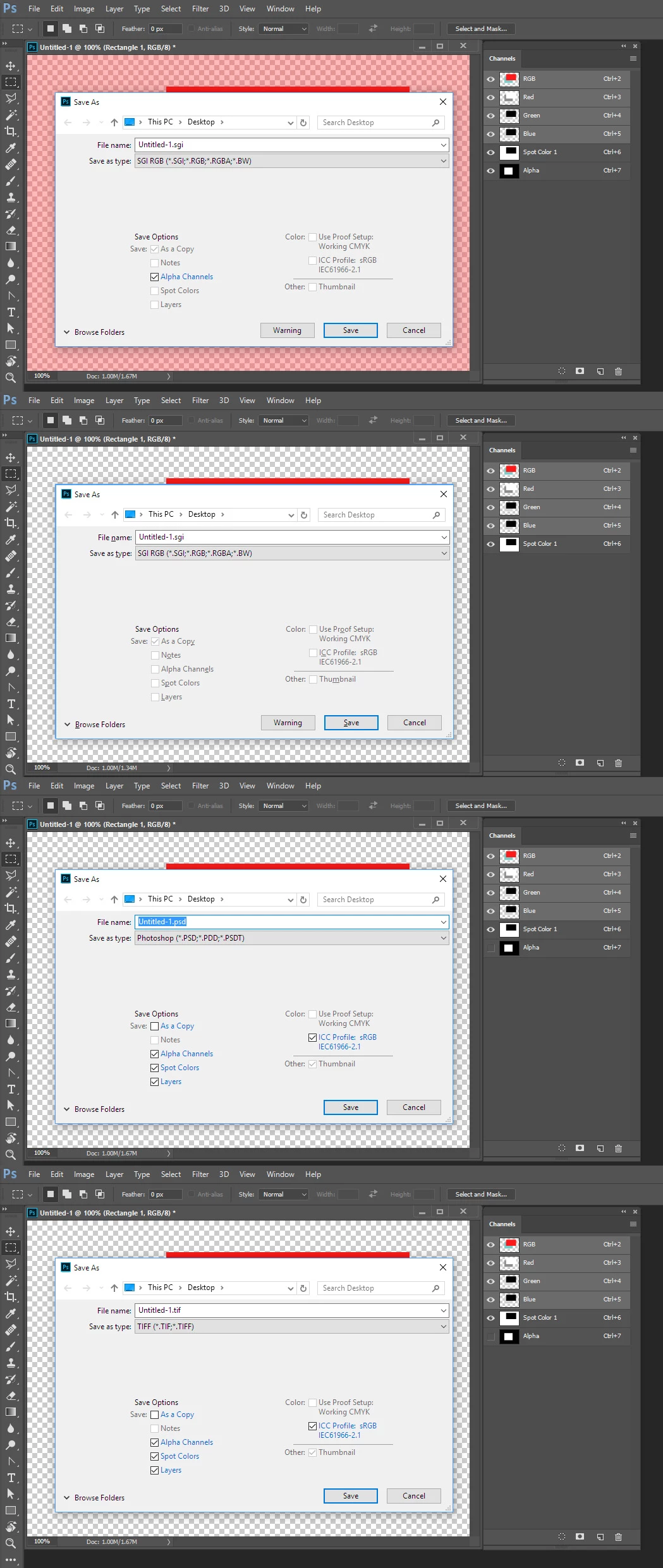

I just installed the Plug-IN I see .sgi is the default that .rgb is also valid and if you have both an Alpha Channel and a Spot Color channel you can only save and SGI file with an Alpha channel the Spot cant option is grayed out.  If I delete the Alpha channel I still can not  save an SGI with the spot color channel the alpha channel and spot color option are grayed out.  If I have both a Alpha channel and spot channel I can saved a Layered PSD and a Layered TIF with both channels.
When I used the script you posted both .rgb file were saved no save as dialog opened. The night rgb file was smaller then the color rgb file neither had Alpha channels when I opened them. The save as  changed your .rgb to .sgi. When I used save as to save a a .SGI when I opened that sgi file it had two alpha channels.
