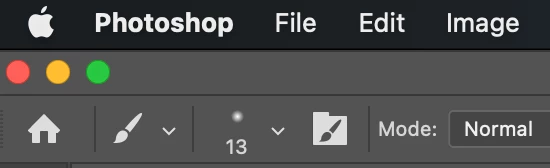

Click the green button on the application frame to fit it on your monitor:
Does the problem go away?
