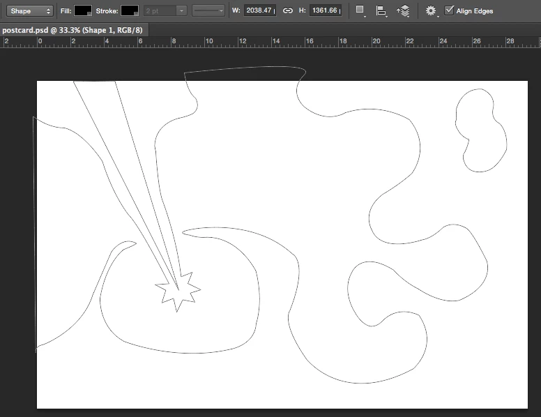

I drew a few shapes with the pen tool and had them filled in. This worked just fine. I wanted them all on one layer, so I selected them and hit merge layer. The stroke and fill disappeared and won't come back. The shapes menu says the stroke and fill are on but I can't see anything. Turning them on and off or changing the color doesn't help. Restarting photoshop doesn't help. Going into paths and remaking the shape doesn't help. I really don't want to redraw this whole shape- where did my color go? I'm working in the Mac version of CS6.

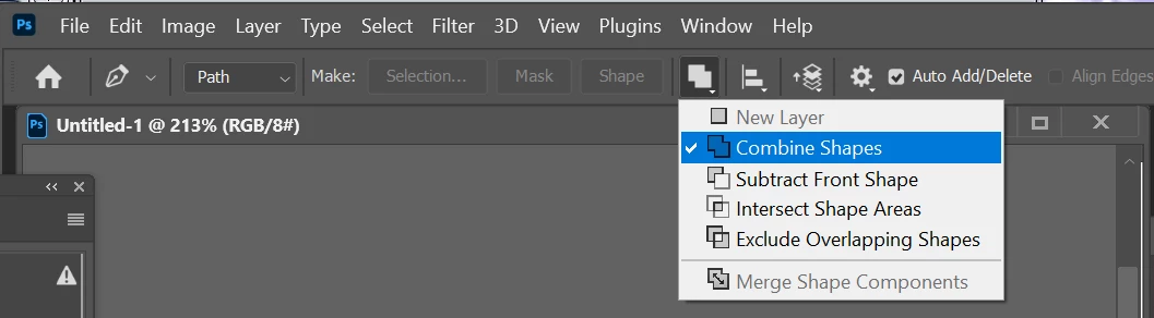

So before merging the 2 shapes, you need select your path tool, select all the pts on both shapes, and pick the combine shape option here. then just combine the layers afterward. It should retain the properties of the shape

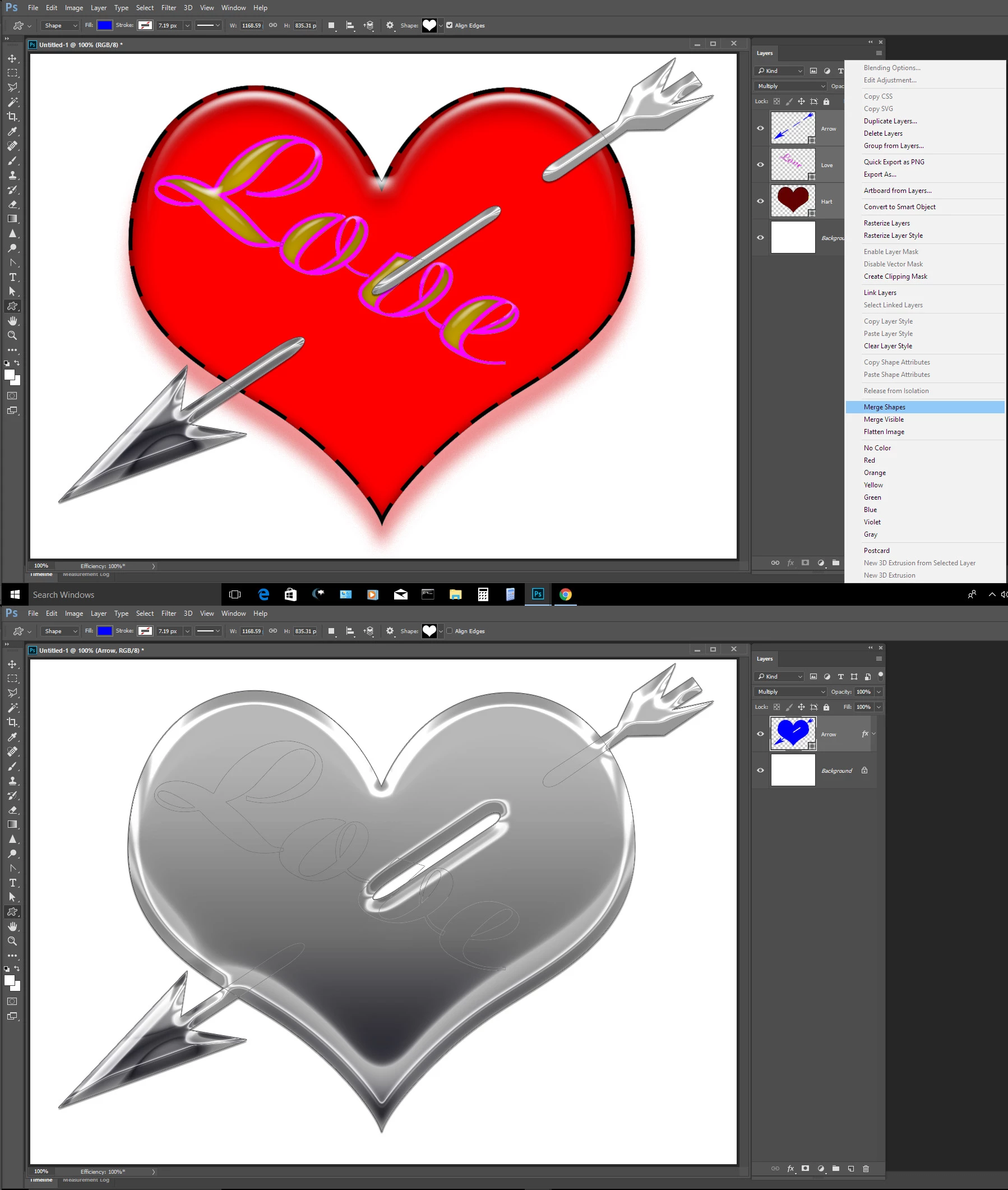

Could you show both the layers Palette and the Paths  and Target the shape mayers you will merged before you do the merge shape layers.  Something like this:
JJMack
JJMack
October 8, 2017

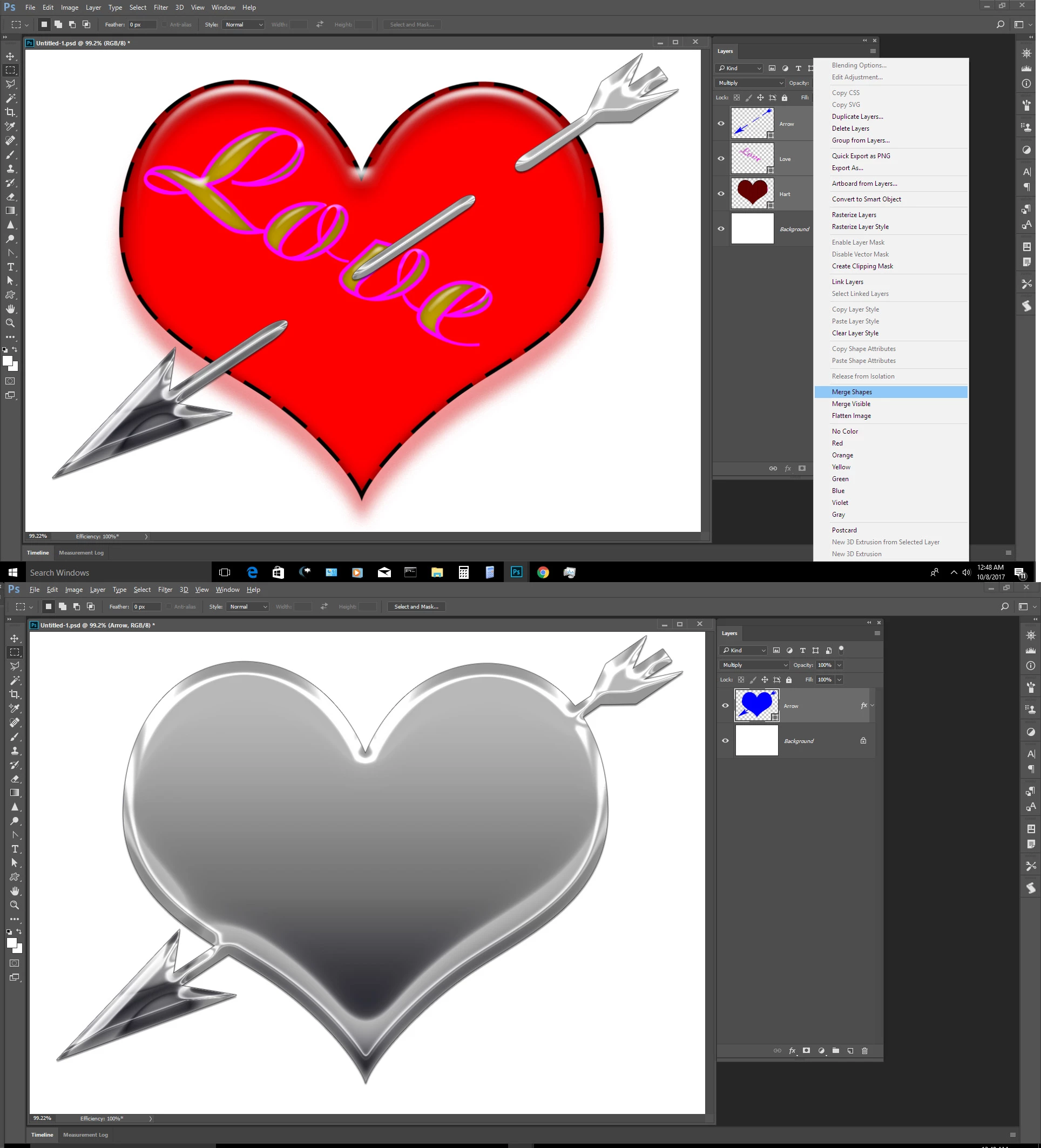

A Shape layer is basically a fill layer with a vector layer mask  and that vector layer mask path may be stroked and may have a layer style.  If you merge shape layers I would think that the Vector layers mask paths would be merged.  If each layer had a different fill I do not know what the resultant fill would be and if some of the shape layer were stroked  and other not I do not know how the merge path would be stroked then the are the layer styles. Let try an experiment. To me it look like the top shape layer wins. Its style, its stroke or no stroke it fill is what is used for the merge. However I do not know why the Pathe merged like the did the middele arrow shaft  looks lik it was suntracted or excluded IMO it should have bee add....

All the fills were the same- just solid black. Now they look as if I selected no fill even though the fill and stroke should both be black.

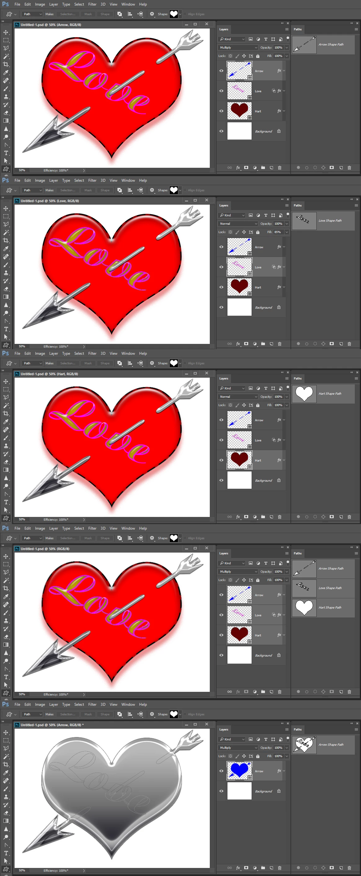

Target each shape late and look at the path in the path palette.
In mat case the Arrow seemed to hale worker wrong. The arrow middle shaft path look correct in the path palette  combine not subtract to make sure  I selected the three closed path and set them all to combine the Merge shapes layers worked correctly.
I still do not know why the original pathe did not work. I tesed both CC 2014 and CC 2017 the worked the same.
