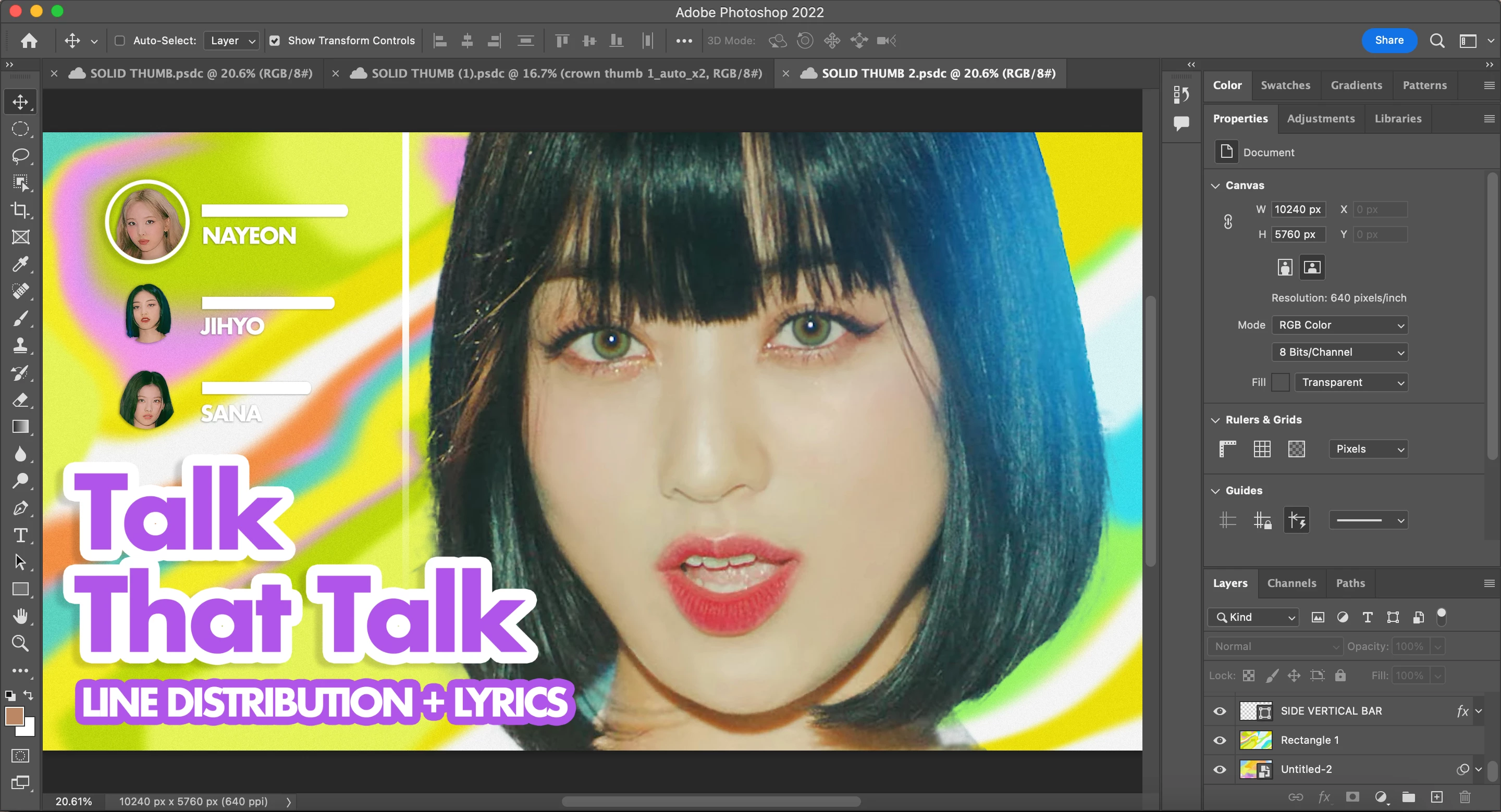

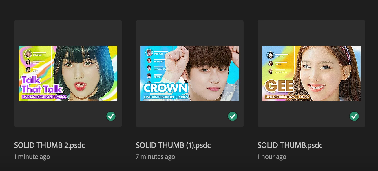

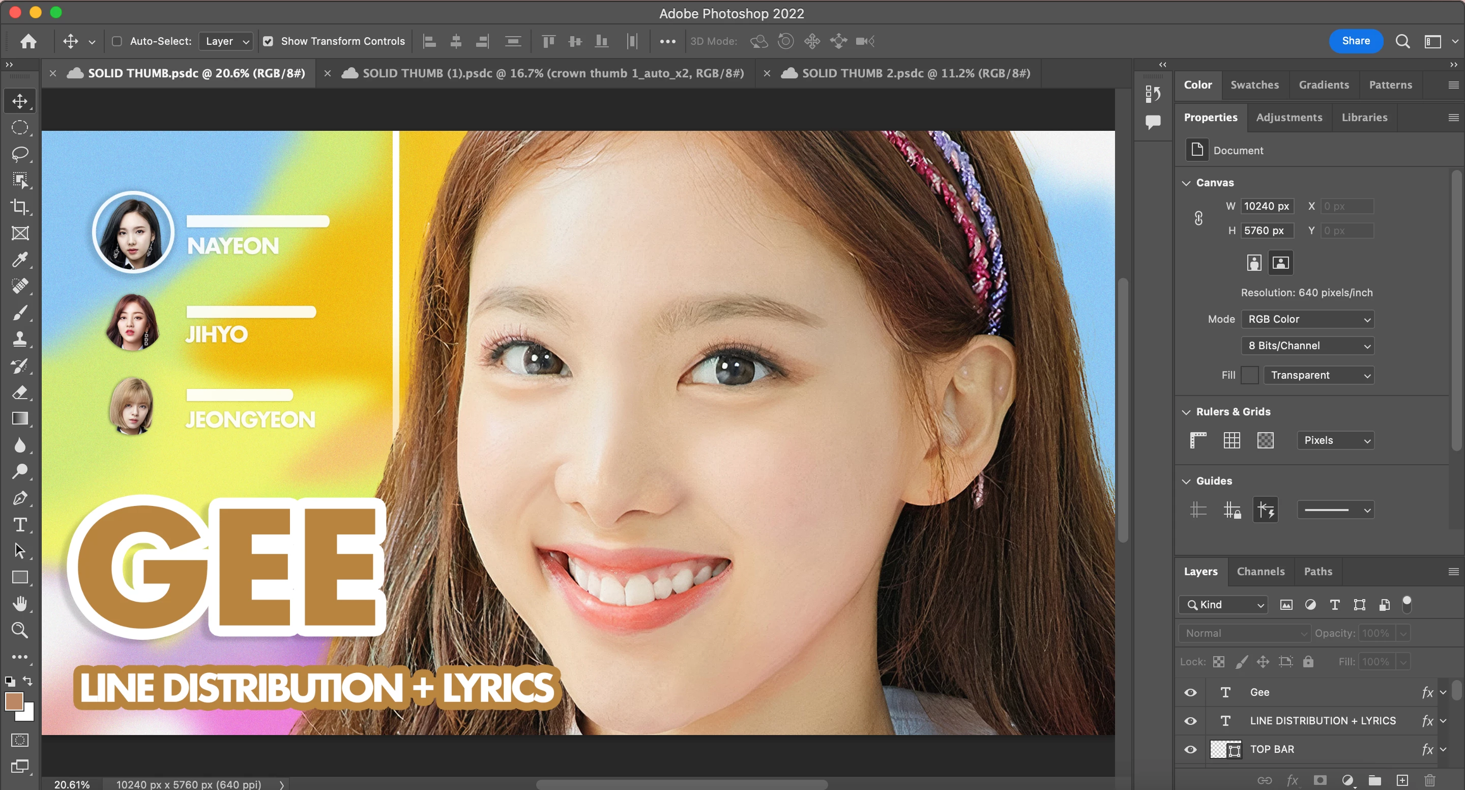

Kany5CCFAuthor
January 23, 2023
This is what the projects look like when I click the home button
Yet this is what they look like when I actually open the project. Nothing happens when I sharpen them inside of the project but the sharpening shows when I click the home button to look at all my projects. Additionally, the sharpening doesn't show when I export the files.
