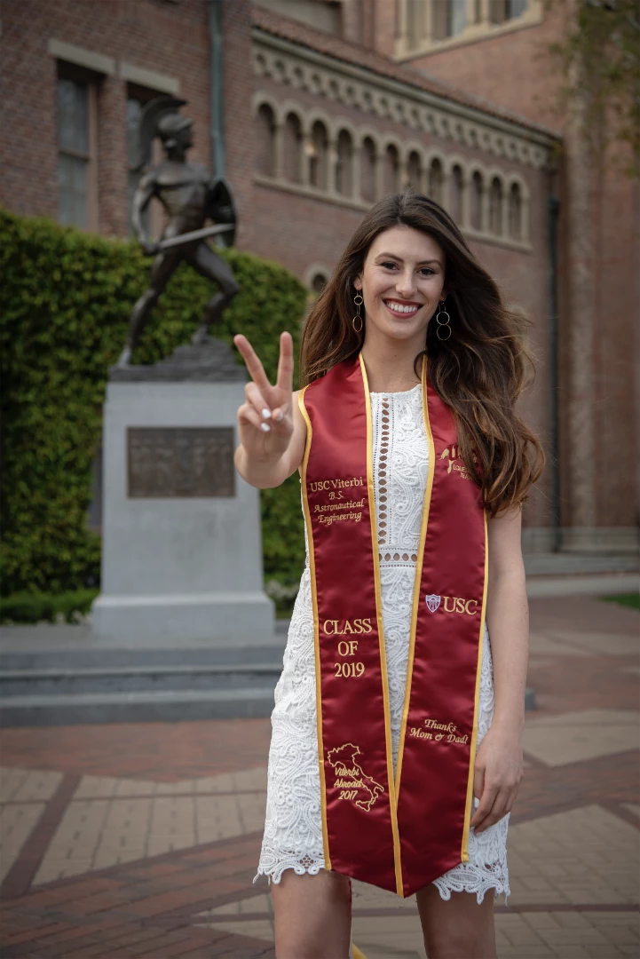

I have a client who wants me to level out/shorten her graduation sash (her right side) to match the left.  I have looked on the forums and online and have not been able to find a solution in PS.  Can someone point me to an article or send me the instruction on how to accomplish this?
Correct answer jane-e
Would she be okay with lengthening the one on the right?
To shorten the one on the left, you will need to recreate the leg, background, and lacy dress. Lengthening the other is just recreating the maroon and gold.
Either way, make a good selection — the Pen tool is best, then convert to a selection — and then use the Clone Stamp tool to get the pixels from another area.
Jane

I honestly think the original picture is more interesting & natural feeling.  If you even up the sash ends, the writing on the sash is not lined up properly & looks odd.  I would advise the client to leave it alone.   Or as Ussnorway said, re-take the photo.
D Fosse
April 17, 2019
This is a fantastic image, with a wonderful capturing-the-moment freshness.
So I'm with Nancy here. Why does it have to be perfectly symmetrical?  And I would certainly not try to reshoot - not in this case. Chances are it won't be nearly as good.
In short, tell the client to not even think about ruining this image

the best option is to retake the photo

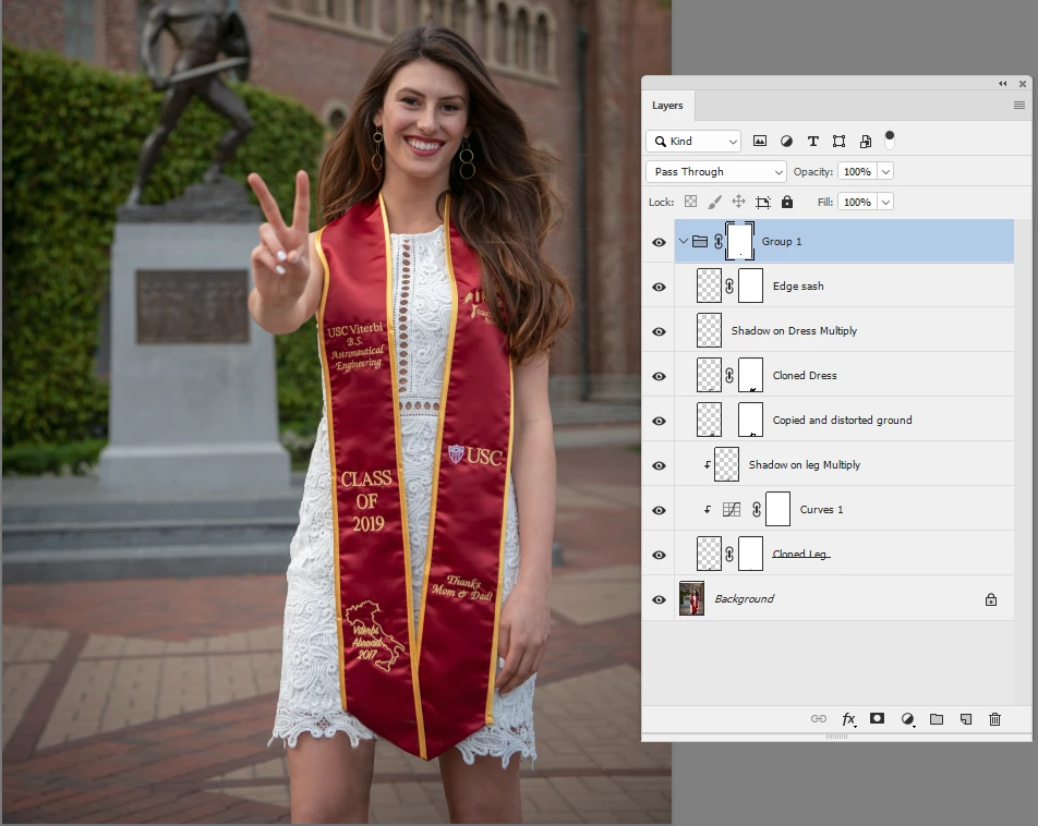

davescm
April 17, 2019
Hi

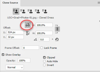

With some cloning you can do this. One tip -remember the clone tool can be reversed left to right so that your clone is flipped - useful for the dress.
